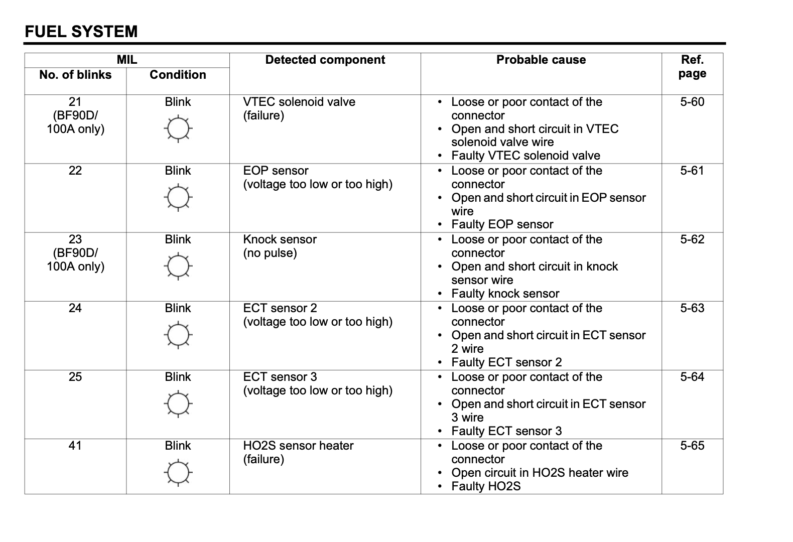

I just realized that my earlier search for DTC26 might have been a victim of Ai or wishful thinking, pretty it told me "oil pressure signal" because I had it unplugged, I just searched again and it gave me a generic answer "sensor out of range" but in reference to ECT.
I have a manual for BF90D and it jumps from DTC25 to DTC 41.
Also overheat light comes on when it starts beeping, but I can't remeber if CEL comes on...
Might be chasing wrong symptom with DTC 26 being a memory code and I'm simply overheating due to bad t-stats, which are leaking BTW.

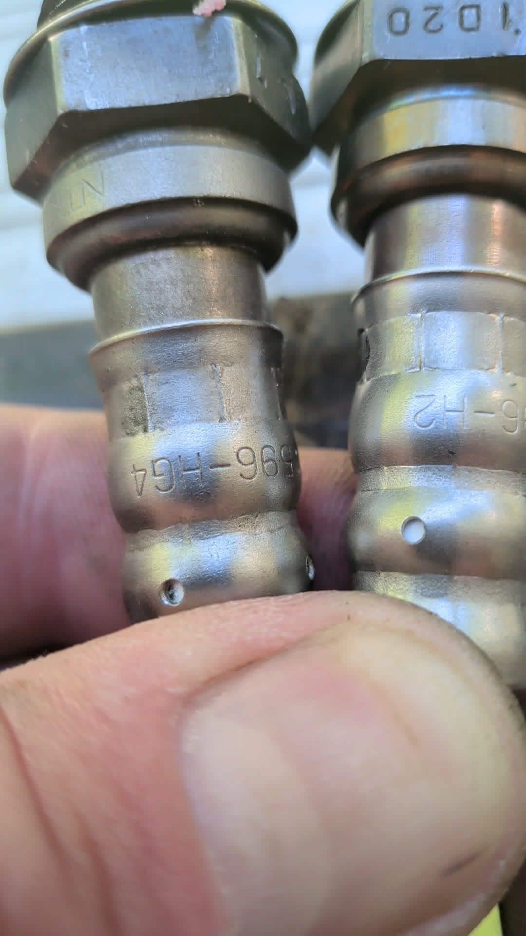

Do you know if those sensors I listed are backwards compatible? 003 is for the older PRE-NMEA ECU that I have and -H01 of for the 2017 and up, only $20 difference from Yumbo, quite a bit more when buying here in US
Always buy according yo serial number, if the part number is different then there is reason for it
My engine is a later model DK4 and has a 1300000 serial number while ECU is from older engine, DK1 or DK2, with 1000000 or 1100000 serial numbers. Also, Honda lists three different oil pressure sensors for the same serial number... I'd say it helps to understand why they change serial numbers and what fits what.
I was reading somewhere that DK1 and DK2 were all interchangeable and later updated versions work with older engines, they just have faster data processing, better maps etc.

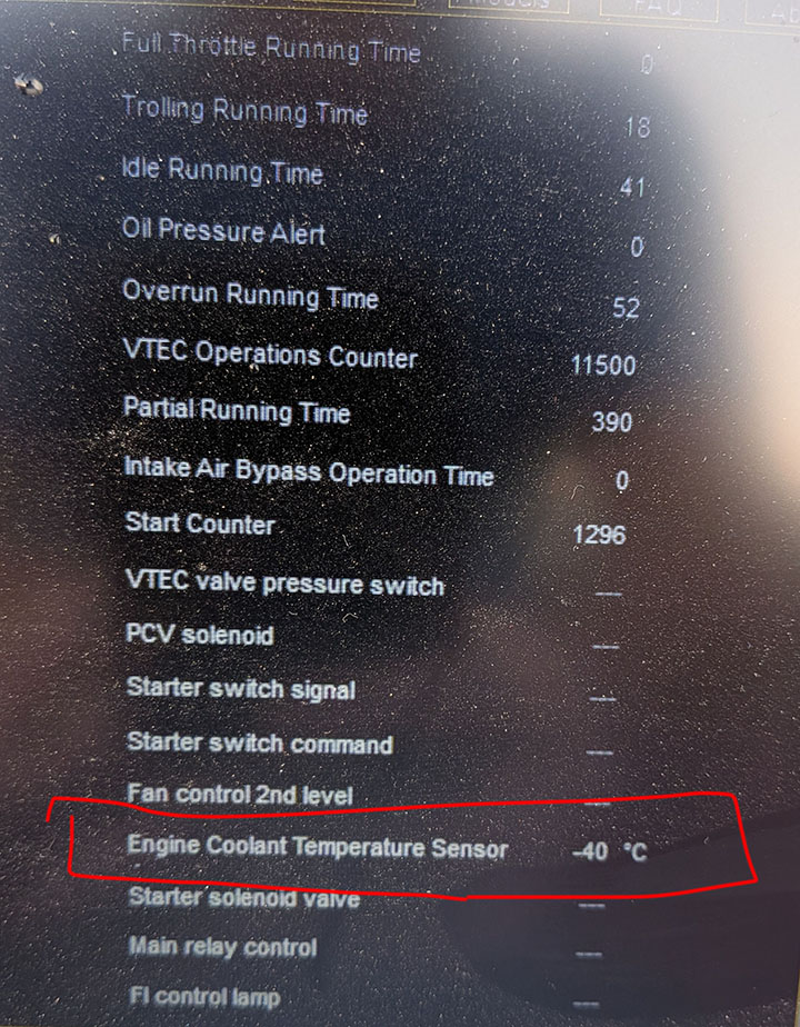

I see 3 ECTs on the engine, but data stream has 4 and the last one is reading -40ºC, but it's not on the diagram.

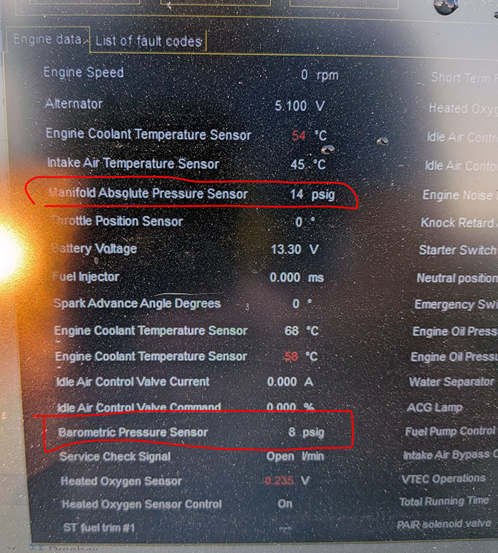

Data shows Baro sensor and it's stuck at 8psi, MAP works fine, 14 PSI when not running, about 8psi at idle.

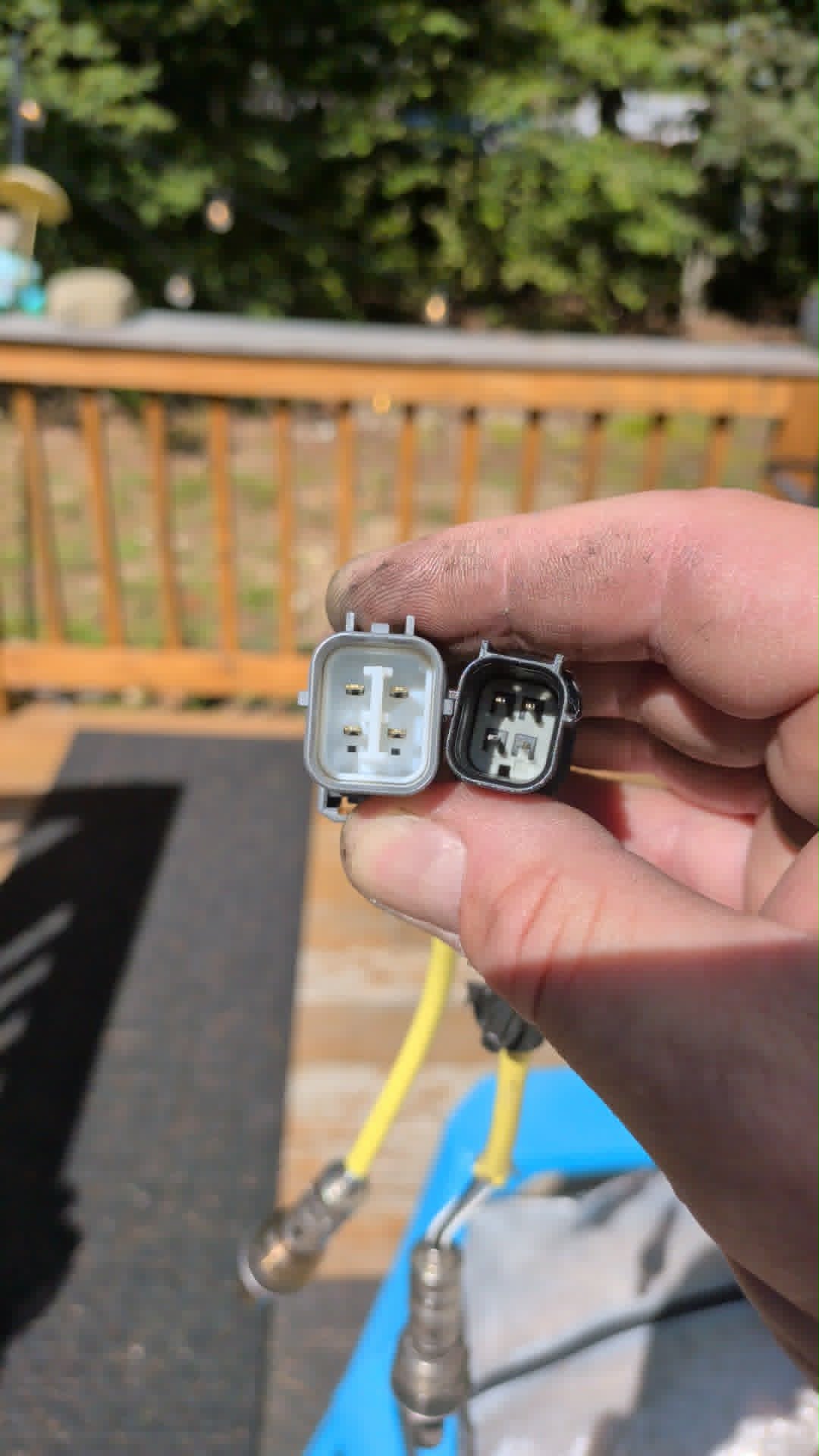

New O2 fixed the surge, seems the genius who swapped the harness just cut off the plug from DK4 and attached it to DK2 harness, but kept whatever sensor was in the engine, there is a reason those plugs are different...

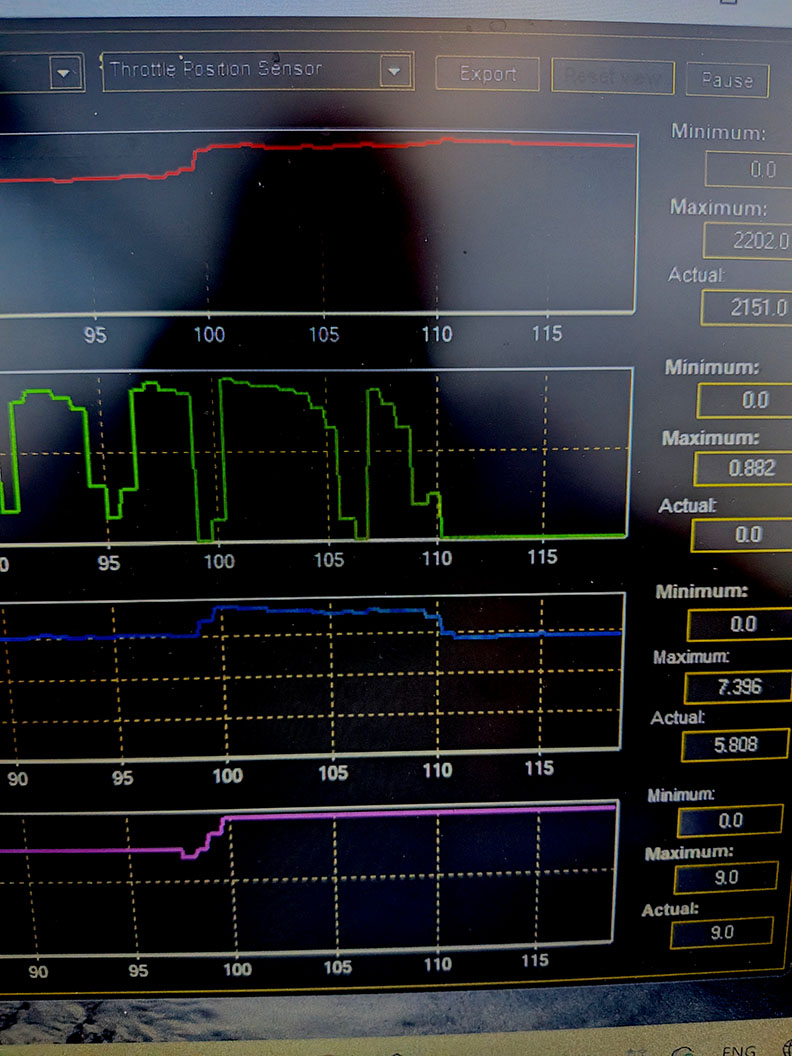

Meanwhile I was able to spend decent amount of time at various RPM and watch the data and here's what happens which makes no sense.
Attached crappy photos of the screen because I have no idea how to take a screenshot on Windows PC
Pics below as follows, top to bottom:
Red-RPM (scale adjusts, top of the sale is 2,000 in the 1st photo and 3,800 in the last pic)
Green - O2, scale is 0-1.000V
Blue - injector signal (mS)
Purple is TPS
1st pic:
After engine warms up Idle is rich, O2 hovers around .800-.900V
at 1,000-2,000 rpm everything works as it should, O2 goes through full range, left side of the picture
You can see where the throttle is set at 9(%?) around 100 mark, boat accelerating and rpm reach 2,000 around 110 mark, that's when injector pulse drops off significantly from around 7.3 to 5.8 and O2 drops to 0V, even see slight RPM drop as engine starts running lean. Took me several tries to get it to accelerate while throttle is set to eliminate the throttle movement as a cause of the lean drop, only thing that changes on the data is RPM, everything else stays constant .
2nd Pic:
Once I hit 3,000 rpm there is a spike in injector signal and O2 goes full rich, this graph starts as I'm at 3,600 rpm and I back off the throttle arounf 1005-1010 mark, throttle is set just after 1010 mark but RPM are still coming down and just before 1015 mark they cross the 3,000 rpm threshold, thats when injector pulse and O2 drop without any throttle input. As I accelerate above 3,000 everything it shoots back up, all clearly reflects on O2 signal again going from 0 to almost 1V.
My guess it's a bad ECU... but I don't have another one to try it, don't see anything else on the data that can affect the mixture, fuel trim stays the same, always +1 so it's got to be a internal mapping on the ECU, right?
3d Pic I'm just slowly increasing the throttle as you can see it goes through the 2,000-3,000 rpm dip and injector pulse drops and comes back up.
Finally!! I have progress!!
Bought a whole spare BF90D (2007) swapped the ECU from it and the miracle happened, it's no longer lean at 2,000 and the 02 sensor switching 3X faster.
My guess is that ECU that I have was defective from factory, Honda doesn't even list that part number as a valid part and someone told me that all early BF 90 had ECU that had to be swapped out on a recall, so I'm wondering if I ended up with ECU that Salmon pulled from a trash bin
