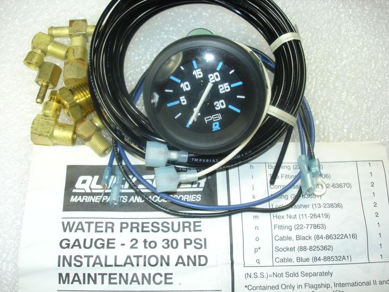

This gauge is in the console of my, new to me, pontoon. The only conections on the back are the two wires for the back light, and a tube that is not conected. The tube runs to the back of the boat where it is also not attached.

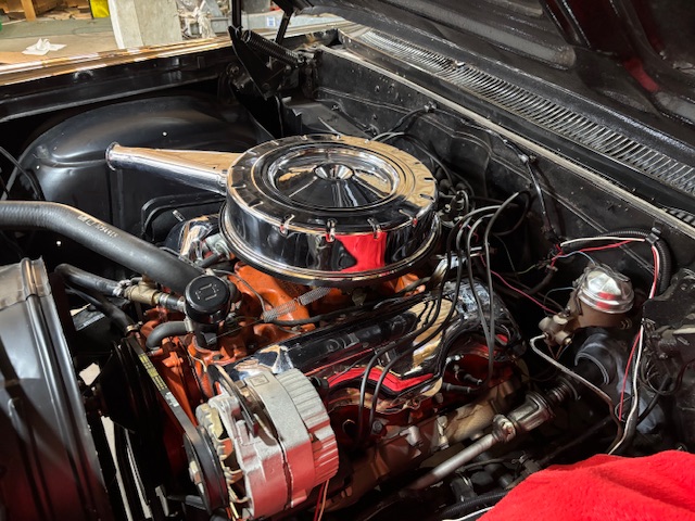

That IS how it was done back in the day with cars. And they ran the hot oil at 40 or 50 psi like that too!
Talk about a rude surprise if THAT spring a leak!!! OUCH!
I use copper line in my old car for oil pressure, also metal line for water temperature.

The gauge in question is a Quicksilver (hence the Q logo) water pressure gauge Mercury/MerCruiser part number 79-825292 that's no longer available but could be seen in the following for sale links if image doesn't load below, https://www.2040-parts.com/quicksil...2-30-psi-nib-includes-fittings-wire-i1023994/
https://www.2040-parts.com/_content/items/images/94/1023994/001.jpg
Thanks Fun Times! I stand corrected!
I fooled myself with the Google search about the Q but should have known better since I'm a long time owner of many Mercs in my time. Oh well, WRONG AGAIN. :/
