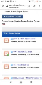

So here is where we move to discuss, in detail, engine rebuilding. Eh? Returntrip, you should have posted here. Trouble is......this gets very few views. For instance right now there is 1 person on it versus 25 for the Mercruiser Sterndrive.
