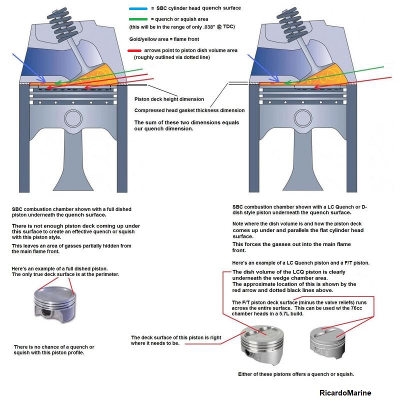

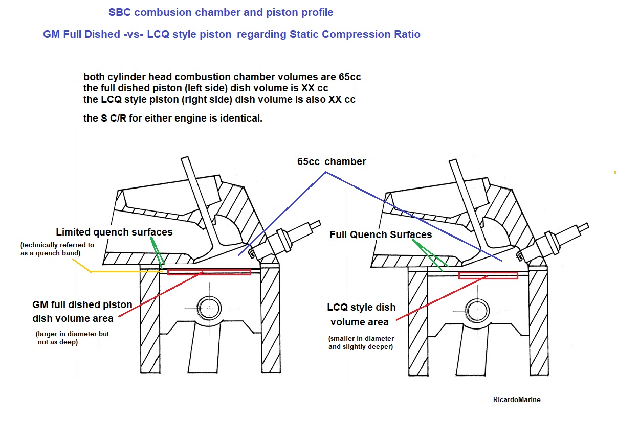

Just for fun, look at the image in post #29 where I explain LPCP and how LPCP is affected by the piston profile and ignition TA.

..... Are you going with the 5.7" rods? Keep in mind that the longer rods move the wrist pin further into the piston, creating shorter skirts.
Hot Rod guys like the shorter skirts... but I think that the longer skirts work best in the Marine version. There are other dynamics that come into play also.
..... Are you going with the LCQ style pistons? A good choice with the Vortec cylinder head quench surface.
..... Do you know what Vortec cylinder head combustion chamber volume is? They differ slightly.
I may even deck off a little material on the new heads, then check comb. chamber c.c..
Don't touch the heads just yet!
Do the math on the cylinder block first ... i.e., deck height, desired quench dimension, compressed head gasket thickness, etc.
I dont want to have the pistons sit too far down in the jugs.
Exactly!
If the piston deck dimension is excessive, in order to obtain a good quench dimension the compressed head gasket thickness would need to be very thin!
Piston deck dimension + compressed head gasket thickness = quench dimension.
Your shop will know exactly what to do.
Please see my images in the thread that I linked you to earlier.
NOTE: the HP Auto guys shoot for a larger quench dimension. For your Marine build, you will want to be a bit tighter!

My Bowtie heads supposedly have 66cc chambers, I was just going to take off the rough decking finish from GM. I will take your advise & wait. I will cc the heads myself to see what they are, prior. I was thinking about steel composite head gaskets, somebody mentioned those to possibly use? Im not sure. I do know about compressed thickness calculations, just not sure about what materiel.I also have seen head gasket bore sizes differentiate on cylinder bore size, again, not sure on that one either!
Im looking for a .038 quench when all is said and done.
FYI.... .038" quench dimension is used for the 5.7L Marine build with the 3.480" stroke.
You will want to increase that some for the 6.3L Marine build with the 3.750" stroke.

Look at the illustration whereby I explain LPCP, and then read my explanation as to how ignition lead affects LPCP.
You'll want to also know that with the GM build (full dished pistons) ignition advance is held back to offset the likelihood of Marine Load Ignition Induced Detonation.
When this is held back, so is the LPCP. A lazy LPCP makes for less torque and horse power.

However, is also begs the question; "what type of combustion chamber will be used?"
You cannot successfully build an engine without knowing this!

Sure a proper quench build is ‘more better’,
So you do agree then.... yes/no????
yes ... But that also doesn’t mean an off the shelf GM base engine will not work as it does in a S load of boats around the world every day.
No agreement there.
There are umpteen thousands and umpteen thousands of GM builds out there, and they are working just fine.

Thanks about the switch wiring. What would you recommend on stroker Quench? .040? or greater?
As said earlier, the .038" quench dimension is used on the 5.7L SBC. This is a suggestion by Dennis Moore.
When the stroke is increased by .270", the quench dimension will be increased some.
I have always targeted .042" to .045".
The Hot Rod guys will shoot for approximately .060" for the 6.3L build due to the higher RPM that these are operated at.

Any idea on a KB part # for the suggested "D' shaped LCQ pistons 4.030.
With your Vortec cylinder heads, you won't be using a D-Dished piston. You'll do better with a LCQ style piston.
Keep in mind (no matter which piston profile you go with) that the piston must be correct for the 3.750" stroke and the 5.7" connecting rods.
