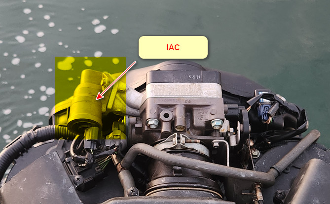

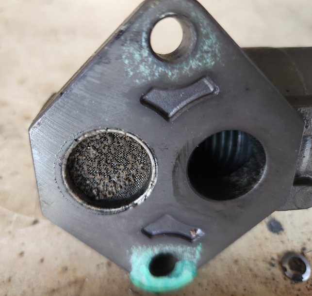

Good new. A local marine mechanic pointed me to the Idle Air Control (IAC). It is a valve at the top of the engine and it is super easy to take off with just 2 bolts. The screen is caked with deposits. I sprayed WD40 on it and blow it clean. Engine is not stalling anymore. It still idle rough at the start at about 500 RPM. After about 1 minute, it will smooth out and rev up. Hopefully the boat will hold up until end of the season. According to the mechanic, I should have the valves checked and adjusted on next service.

The engine start to stalling again. I need help on a few things.
1. I took off the IAC and to my surprise one of the screen is "cake" up again. This is only from 2 hours of engine run since my last cleaning. Is this normal? Is there any way to clean inside the IAC?

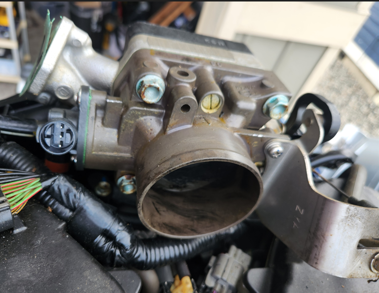

  • Took off the throttle body and gave it a good clean.

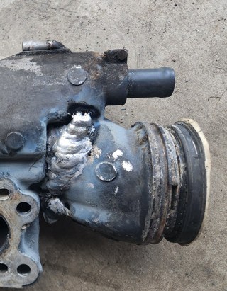

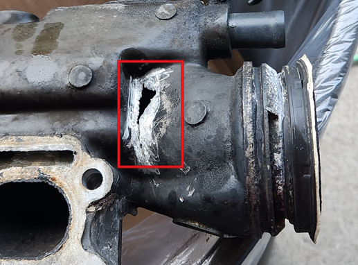

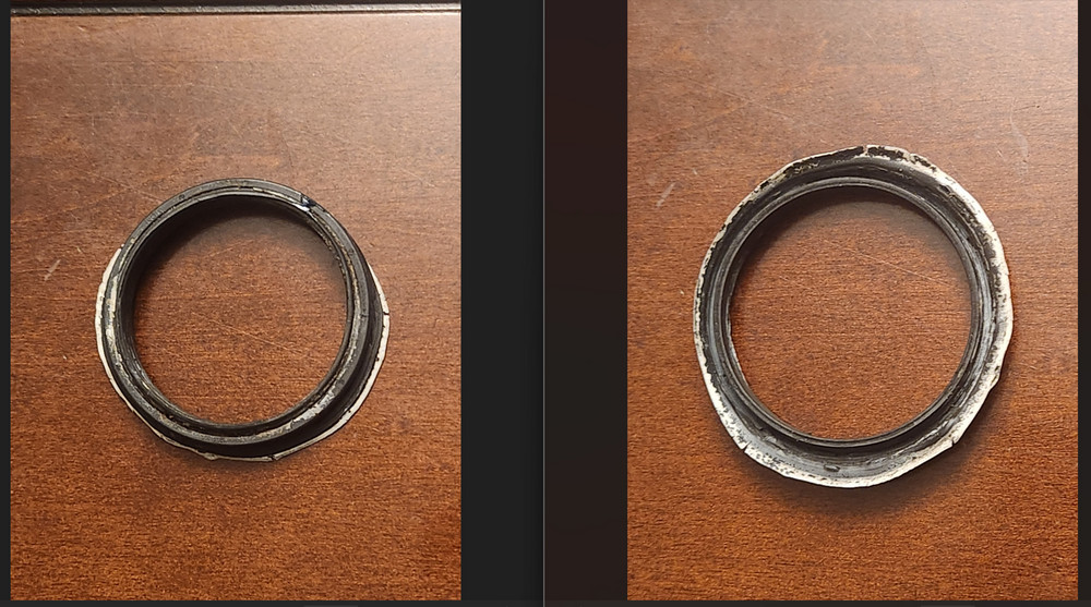

I thought things are going my way, but then things turned. When I tried to put the manifold back, I realized I took out the exhaust guide seal when I forcefully took out the exhaust manifold. The exhaust guide seal guide should stay with in the bottom water jacket and that is why there is a warning to not "shake" the exhaust manifold on removal in the service manual (pg 5-118 step 7).
According to the service manual (pg 5-120), the exhaust guide seal should be change out every time. However, in order to change out this part, we need to take off the lower unit and the lower rubber engine mount (pg 12-57). This will be a really big job. Question for the guru here. Is there a way to put the exhaust seal guide back without taking off the extension case?
By the way, I am fighting with my lower unit now. I could not get it off.
I decided it is too much risk to take off the engine mount to just replace the exhaust seal guide. I am going to see if I can push a new exhaust seal guide down from the top. Any advice on how to do this?

Glad that I did not start to take apart the engine to replace the exhaust seal guide. I am quite sure I will run into more issues. I will try to clean up the parts and hopefully I can put the manifold back.

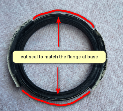

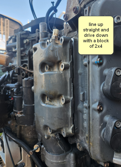

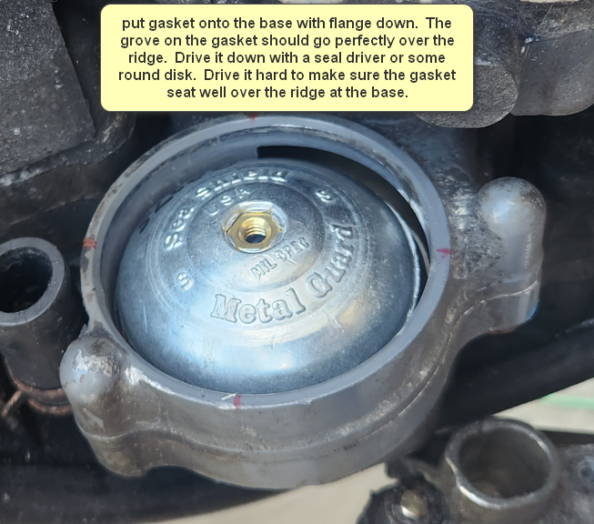

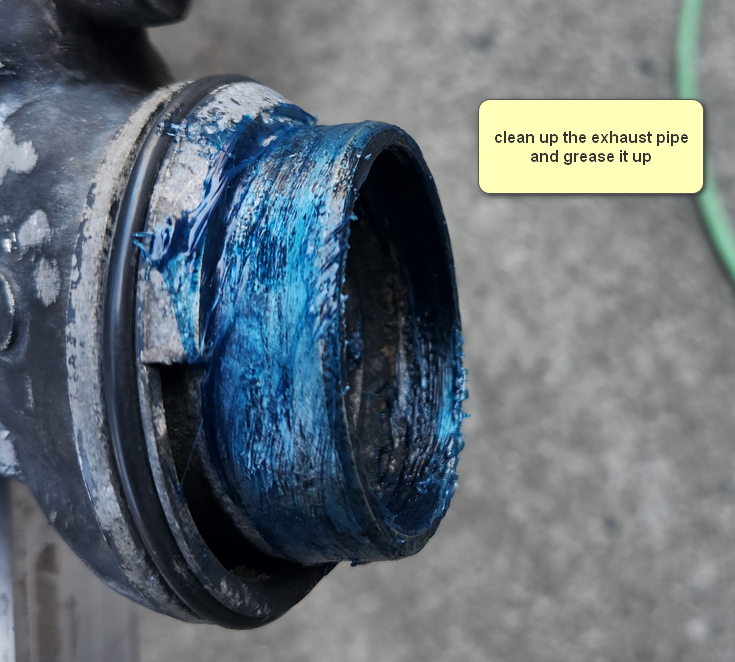

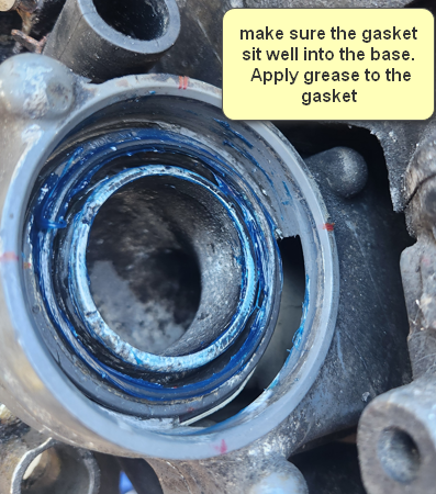

Just for reference. Here is what I did to get the manifold back in place. First I cleaned up the base really well with a wire wheel/brush on a drill. Got rid of of all old corrosion. I put in some gasket material in the grove and the outside ridge of the exhaust "ring". Made a note where the flange comes out in the base. Cut off the seal on the gasket where the flange is such that I can drive the exhaust seal guide into the base. Used a trim tab zinc anode as a driver to drive down the seal guide. Cleaned up the exhaust pipe with a wire brush on a drill. Applied grease to the seal guide and the exhaust pipe. Line up the manifold and the base. Used a piece of 2x4 and drive the manifold straight down into the base. With the new O-Ring, it may take some force to accomplish this. I had to take off the fuse "box" so I have room to line everything up. Here are some pictures to help to understand the process.

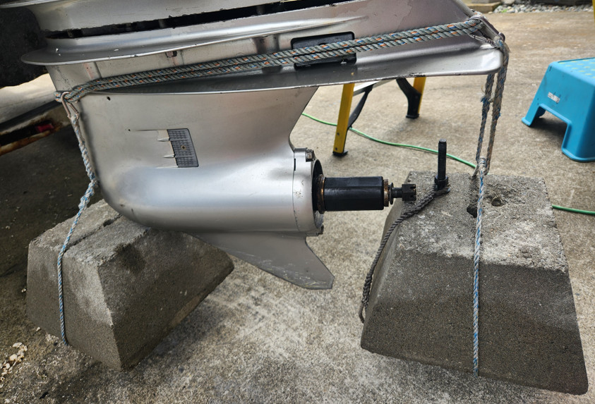

I also won another battle with my lower unit. I tied a rope around my lower unit and hang 2 50lb concrete anchors off it. Spray with PB blaster and bang on the case with a dead blow especially when you are frustrated. After a few days, I finally won the battle.

I cleaned the IAC valve and the throttle body. Changed the high pressure fuel filter and lower pressure fuel filter. Need to put everything back and hopefully the engine won't stall anymore. The war continues.

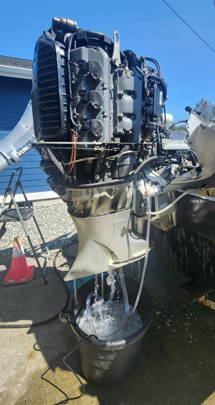

Just for reference. Here is a way to do a complete vinegar flush of my engine. Here are the parts you need. You can get them at home depot and Costco.
- 4 gallon of vinegar (4 Monks brand) from Costco. I dilute my solution 5 parts of water to 1 part of vinegar.
- a big container. You can get a big container for under $10.
- a sump pump (the lowest power one will be sufficient.)
- 2 hoses. One to fit into the water tube going up to the engine. One to fit onto the tell tale tube.
- a few hose clamps.
Take out the thermostat on both side of the engine. Put all of the hoses into the container and you will have a closed system, so none of the solution will spill out. Any sump pump will be strong enough to push the solution through the engine. Run the system for a few hours and it will clean your engine out.
