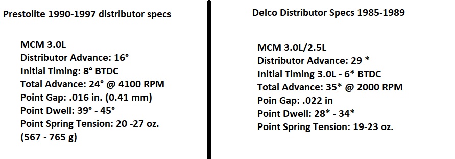

24 total Jpeg of merc service manual. Sounds like mechanic who serviced your distributor or tested it on a Sun marine is more familiar with automotive advances which will be in the 30s
Distributor spec
MCM 3.0L
Distributor Advance: 16°
Initial Timing: 8° BTDC
Total Advance: 24° @ 4100 RPM
Point Gap: .016 in. (0.41 mm)
Point Dwell: 39° - 45°
Point Spring Tension: 20 -27 oz.
(567 - 765 g)
This means that your mechanically advancing ignition distributor offers 16 degrees of mechanical advance, of which does NOT include BASE advance.
This is your BASE advance, and has ZERO to do with any mechanical advancing.
BASE advance is controlled by the initial position of the distributor housing relative to the crankshaft angle.
We start up on BASE, and we idle on BASE.... and that's it.
Once BASE is set, we tighten the clamping bolt down causing it to hold a continuous 8 degrees of BASE advance.
This represents the "Full In" advance generated by both the mechanical advance and the BASE advance.
In other words, add BASE of 8 degrees to the mechanical advance of 16 degrees, and you have a total of 24 degrees advance @ 4,100 RPM.
While strobing the markings dynamically, BASE can't help but to show up along with the progressive advance.

I have had the distributor spun and it is getting 23 degrees of advance built into it.... too much with a base of 8 degrees, plus 23 degrees gives me the 31 degrees all in im seeing.... somebody had it set up wrong when the PO installed it in the "new motor"... which is obviously why he couldnt get it to run right.
I appreciate all the help EVERYONE has given, and now im sure im on the right track to getting it to run as it should... I suspected the distributor to begin with which is why I switched to the more modern EST distributor, but it had programming issues of its own...

My post got screwed up so here is the text part
My original post of tune up spec data was incorrect Sorry, The specs were for a Prestolite Distributor for 1990-1997 140 4 cyl engines (manual 13 )
The 4 cylinder Delco distributor is a very simple design. As simple as it gets.
Your DELCO distributor is set up correct as the pictures in previous post show. That is from The Manual 10 - Engines GM 4 Cylinder All 1985–1989
NOTE: Initial advance is NOT 8* BTDC. The manual says 6*BTDC and it is safe to use 4*
So you need to decide which is the correct distributor for you engine parts combo if not original DELCO OR PRESTOLITE as there is a difference.
The way to change max advance is the weights. Not sure where to find different ones as ALL Delco distributors for Merc Marine 4 cylinders use the same weights.
The springs set the rate/RPM at which it gets there. Even the 170/190 470 merc 4 cylinder delco distributor weights and springs, are all the same.
So if those were changed you need to acquire an different weight set and the springs.

Here is the comparison You may be running the wrong plugs so be sure what heads you have and what plugs are required. If the LTS plugs then a Prestolite Distributor should be used.
1985-1989 181 cu inch 3.0L Delco Distributor
Spark plug or equivalent AC-MR43T .035" gap
1990-1997 181 3.0 and 3.0 LX
Both use Prestolite Distributor
3.0 Spark plug
AC-MR43T Gap .035"
3.0LX Spark Plug
AC-MR43LTS Gap .035"
Regarding a mechanically advancing ignition system, most any well seasoned mechanic knows that a change to BASE or Initial advance, causes the same exact change to the TA, and visa versa, and also knows that Total Advance is far more important over that of BASE or Initial.
These are flyweights.
The MAX advance can be changed by either:
....adjusting the position of the housing and letting BASE be what it is.
....installing different flyweights.
....or in some cases, by adjusting the flyweight limiters.
Not only the springs, but also the profile of the flyweight cams.
And that is where the Sun, Allen and/or King machine comes into play.
Regarding the above ignition advance info, and considering the year model differences, please explain how the same basic 4 cylinder GM engine can be given two entirely and drastically different total advance numbers at the respective "full in" RPM!
In the first example (left side), the engine is given 24* @ 4,100 RPM.
In the second example (right side), the engine is given 35* @ 2,000 RPM.
In the second example (right side), the engine is given 35* @ 2,000 RPM. ""
