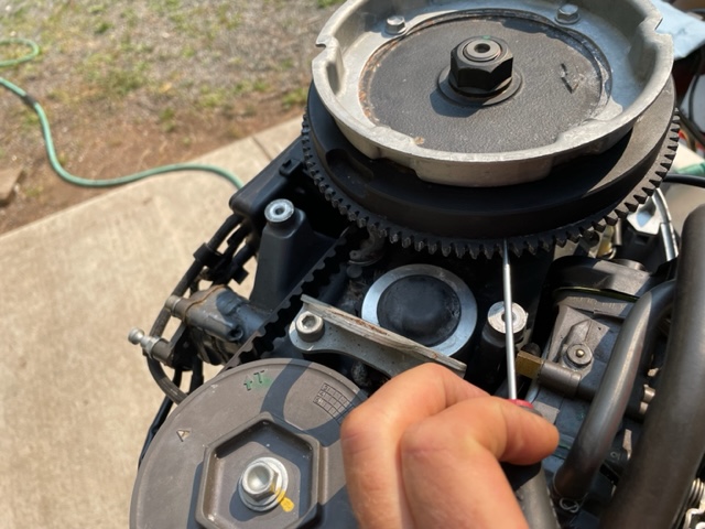

Do you have the service manual? Have you checked the timing marks? Your instincts may be accurate. They do jump time even when the belt looks ok.

Does anyone happen to have instructions for timing alignment for a bf30? i see all the marks but i am unsure what is my landmark for the flywheel T.
i believe i have confirmed timing is correct. By way of the alignment shown in the photos. Also confirmed no.1 piston is at top.

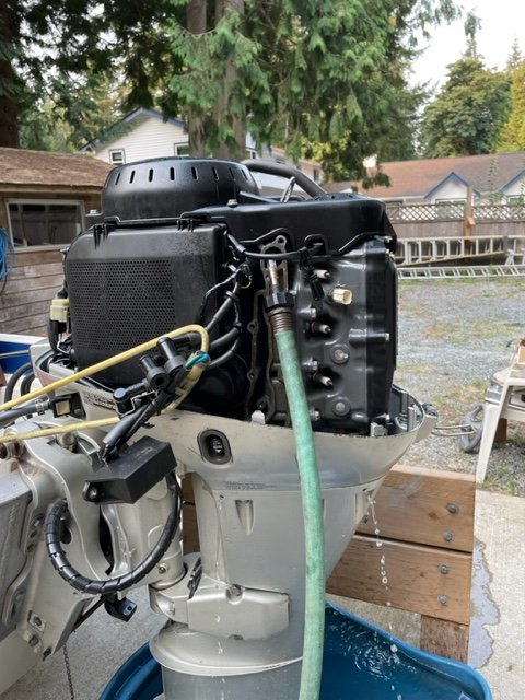

And put her in a tub. (This motor did not have a thermostat when it came to me). Still no pee and she's getting warm. Even the lowers. So it seems i have a cooling problem. It doesnt necessarily mean the temp gauge was correct. The motor never got warm in those trials cause she didnt run long enough.

Impeller will right itself when engine starts. If it has never been done I would definitely remove the water jacket for a clean out, especially the little slotted hole at the bottom, and replace the anode whilst you're in there.
Question on the internal waterways: if i plug a hose into the wash plug and pump water in should it reach the motor? I did this with the water jacket off and no water was present in the motor from the hose below. I did also run water directly into the thermostat orifice and that water did seem to work its way through. i am wondering if i have a blockage at the pipe from pump to motor?
Ok The cooling system has had a full service. Now she pees like a race horse. I have discovered that she is running on 2 cylinders at the most.
