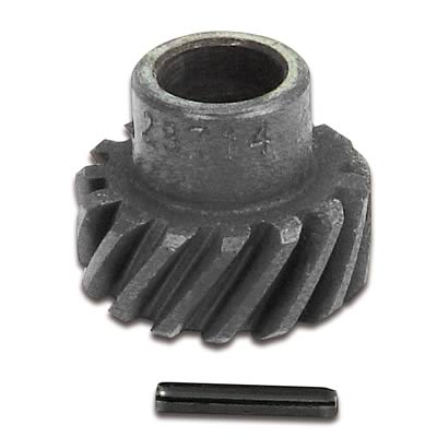

Here is a Reverse Rotation Windsor...... FORD 75-87 8 cyl 351/5.8 W engine.
Note that they are using a chain drive.
This means that the camshaft is also rotating CW (with the crankshaft) when viewed from the flywheel end.
The also means that the camshaft "drive" gear and the distributor "driven" gear are a special cut for the RH Rev engine (in order to maintain CCW rotation of the distributor).
Note the difference in the gear cut between the LH and RH distributor "driven" gears.
With the correct cam gear and distributor gear......, the distributor and oil pump will rotate CCW.
(STD LH Rotation gear on left....................................................... REV RH Rotation gear on the right)
