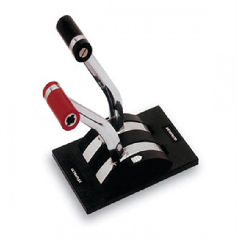

I have a question about my Morse shifter binnacle
1987 27’ tiara with twin 2001 5.7 apha1 gen 2, 2bbl carbs
my Morse shifters were a little stiff and noisy when shifting. I also noticed that the sprig loaded ball bearing had worn a deep groove in the plate with the detents in it.
so I greased the bearing and took the detent plates off and flipped them over.
now my shifters pop up out of the detent position and won’t stay in the forward position and slip back towards neutral when ever I hit a big wave. The outdrives stay in gear but the shifters keep moving back towards the top. So if I power back for a no wake zone and take the load off they will actually come out of gear.
anyhow I’ve been searching and not been able to find rebuild kits. I’m thinking new indexing plates, springs and I design bearings would sort me out.
any thoughts on where I can Aquire these?
