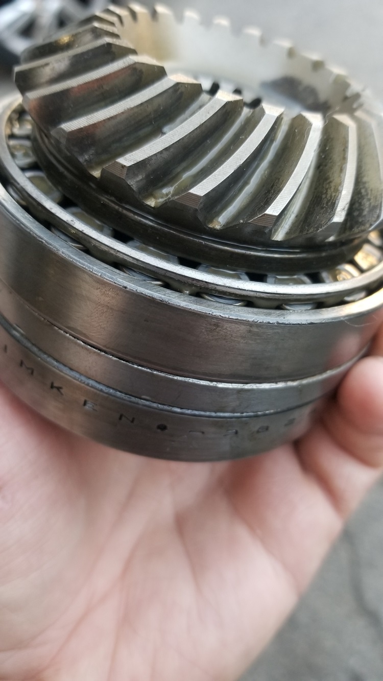

So because I have the drive apart I though of changing the seals on the upper part of the drive, so I got the tool and removed the gears. The thing I discovered is that the 2 bearings in the drive gear assembly don't spin freely at all. I have to hold the gear or put it back in the yoke and spin by hand and rag and when I stop twisting the bearings stop spinning. I have a feeling the shim after the drive gear is tightened on the bearing. This gear assembly does not come apart as soon as the nut is removed, I believe it is pressed in. So I need help with the next steps.
Below is a video placed on Dropbox showing the spinning process.
https://www.dropbox.com/s/lrfa66pe5h7y8c6/Drivegear bearing assembly.mp4?dl=0
The boat is a 97 model with the Alpha one Gen 2 so which assembly is this the 80ft/lbs torque, or the 6-10 in/lbs one. There seem to be 2 or more different ones with different ways to adjust preload.
