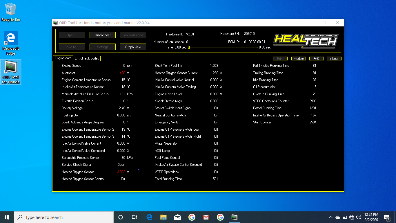

I just purchased the Heal tech OBD kit, I've only used it with the engine off but it works great for stored data. I'll post some screenshots when I have a chance to hook it up with the engine running.
Here is the heal tech OBD with the engine off key on, it wouldn't let me attach the file with the engine running. Probably because that file plays like a video, gives a lot of info trying to figure it all out.
One thing to note which I've also seen with my Dr H, there is a bug in the calculation of the barometric pressure - With the engine off, barometric pressure should be close to the Absolute Manifold Pressure, roughly 29 inHg or 101kPa at sea level. The DR H reports barometric pressure about 40% low. Even with the bug, the Dr. H is a great tool that will pay for itself the first time you have a problem and can fix it yourself without taking your boat to the shop.

The Honda BF 225 has a Manifold Absolute Pressure sensor (MAP) and a Barometric Pressure Sensor. If you take a look at the DR H screenshot posted by 123jayyyy above, with the engine not running, the value from the MAP sensor looks like a reasonable surface pressure reading (101 kPa), but the value from the barometer should be close to the MAP sensor, but it is way low at only 60 kPa. I've seen similar data from both of my engines. This indicates to me the problem is a bug with the DR H software.

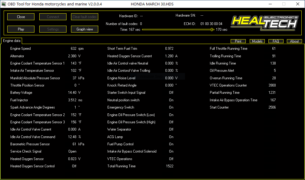

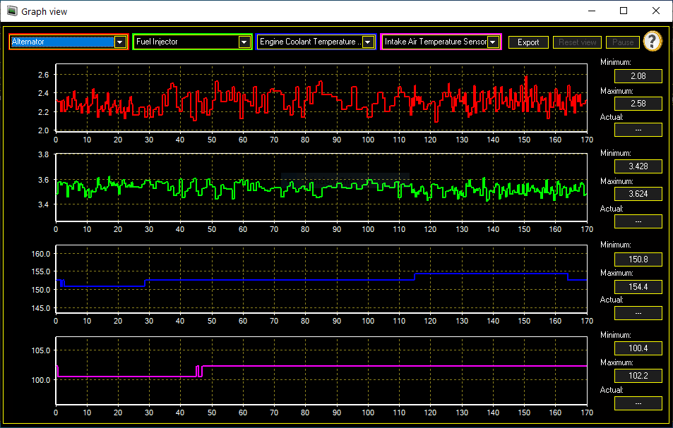

Here is the healtech software with the honda BF225 engine running, screenshots of data and graph.
View attachment 23056 View attachment 23057
