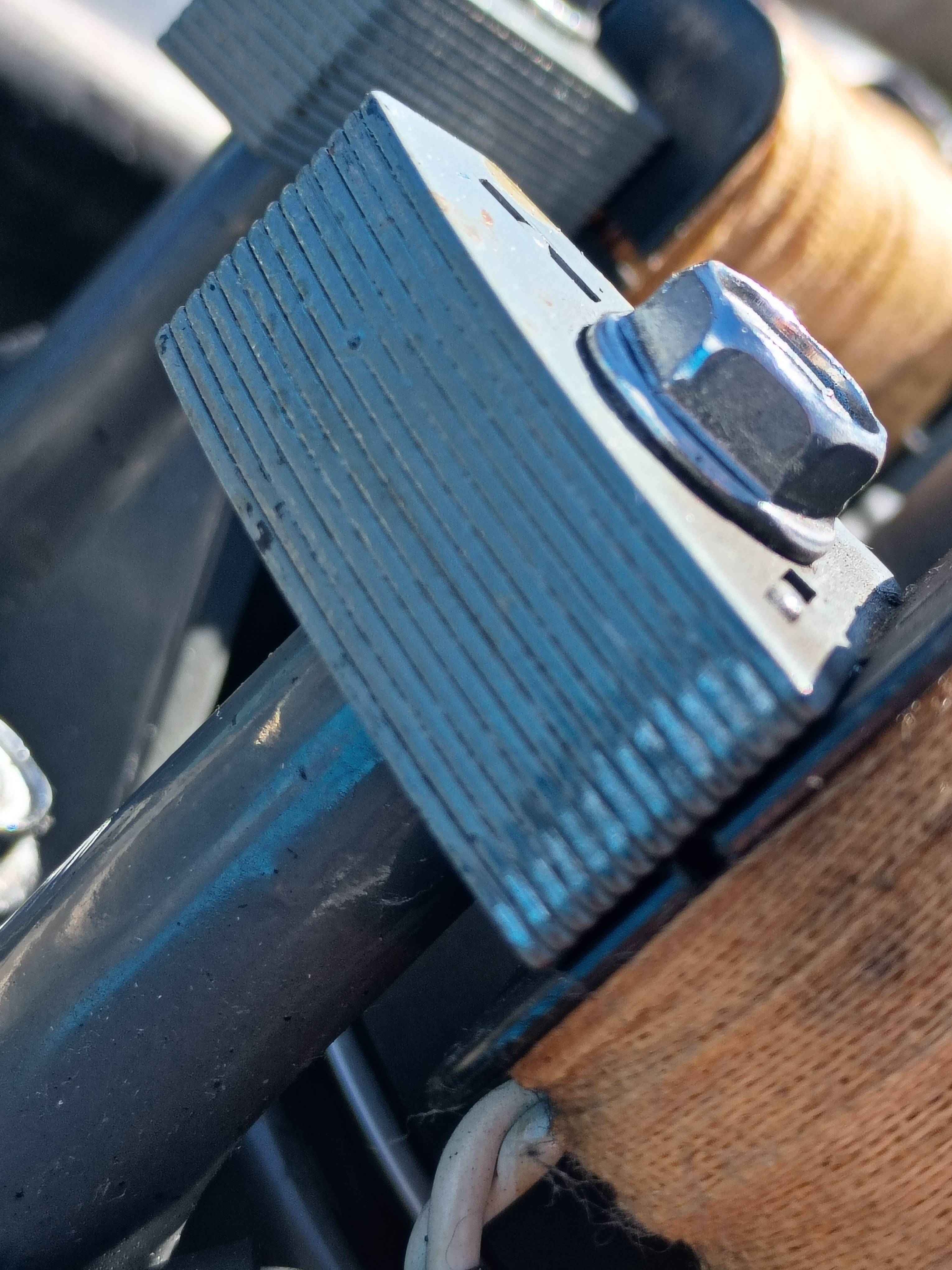

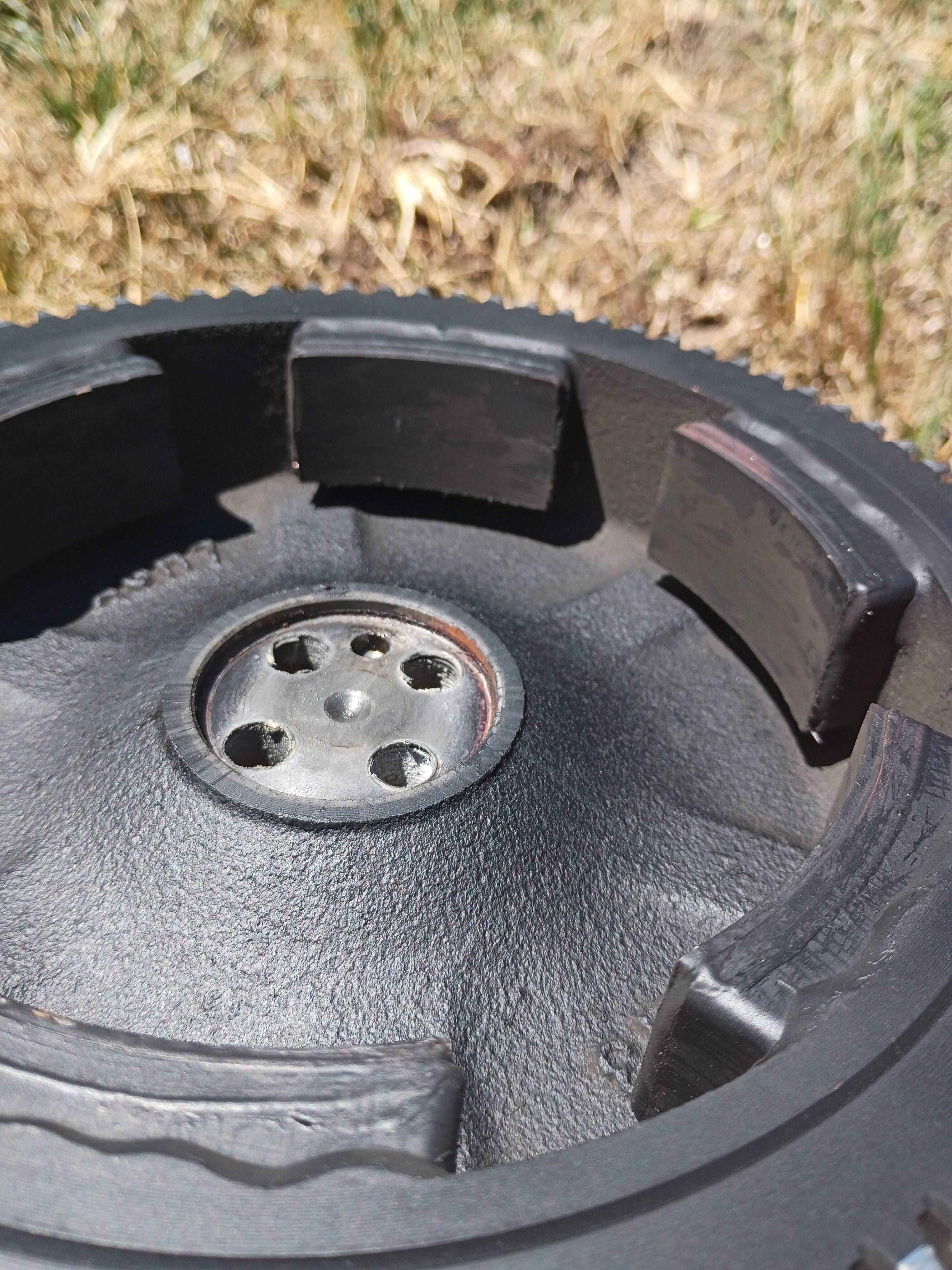

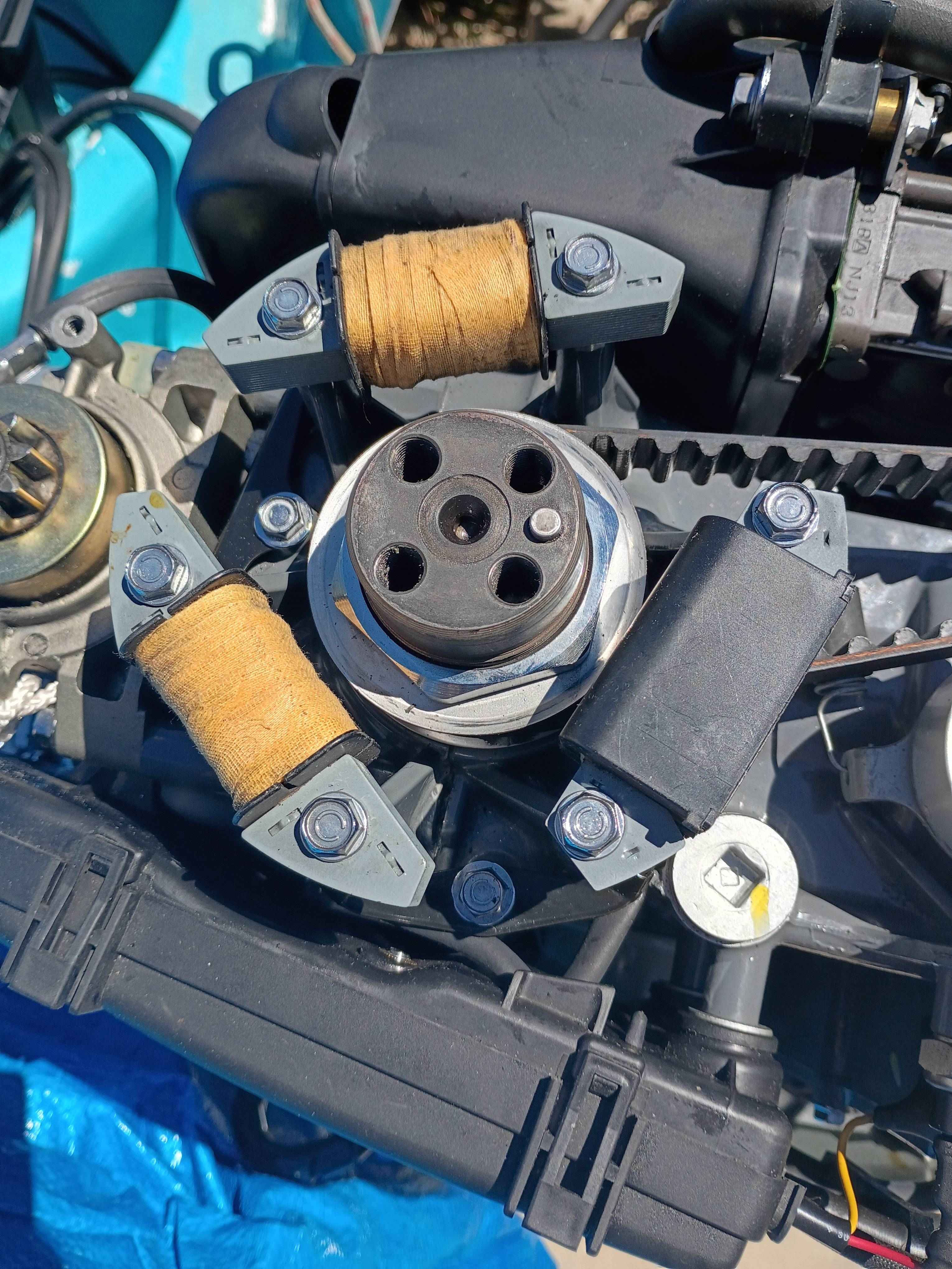

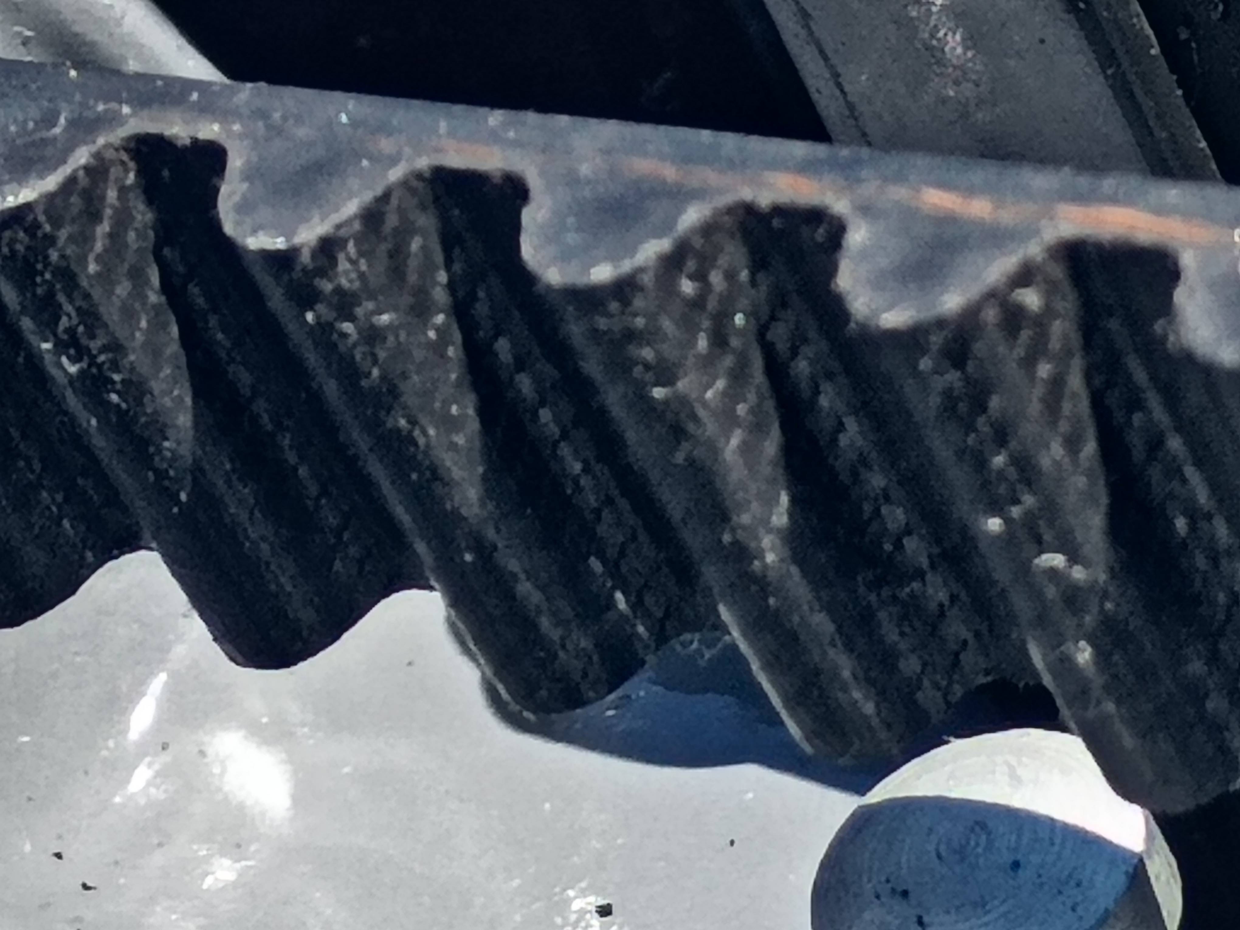

Took flywheel off. Looked ok, 2 statorsupon were wrapped in cloth, 1 was plastic case.
Upon closer inspection saw Mark on flywheel stator and on a couple magnets. Buzzed them all down w grinder , reassembled and texted.
Noise still there hard to say if louder or less, I'm hoping it solved, but still noisy IMHO.

The magnet eventually delaminates and destroys the coils too. Only fix is a new or good used flywheel. I've tried all these thinks before. The manet has a very small clearance from the coil, once it starts delaminating it's stuffed.

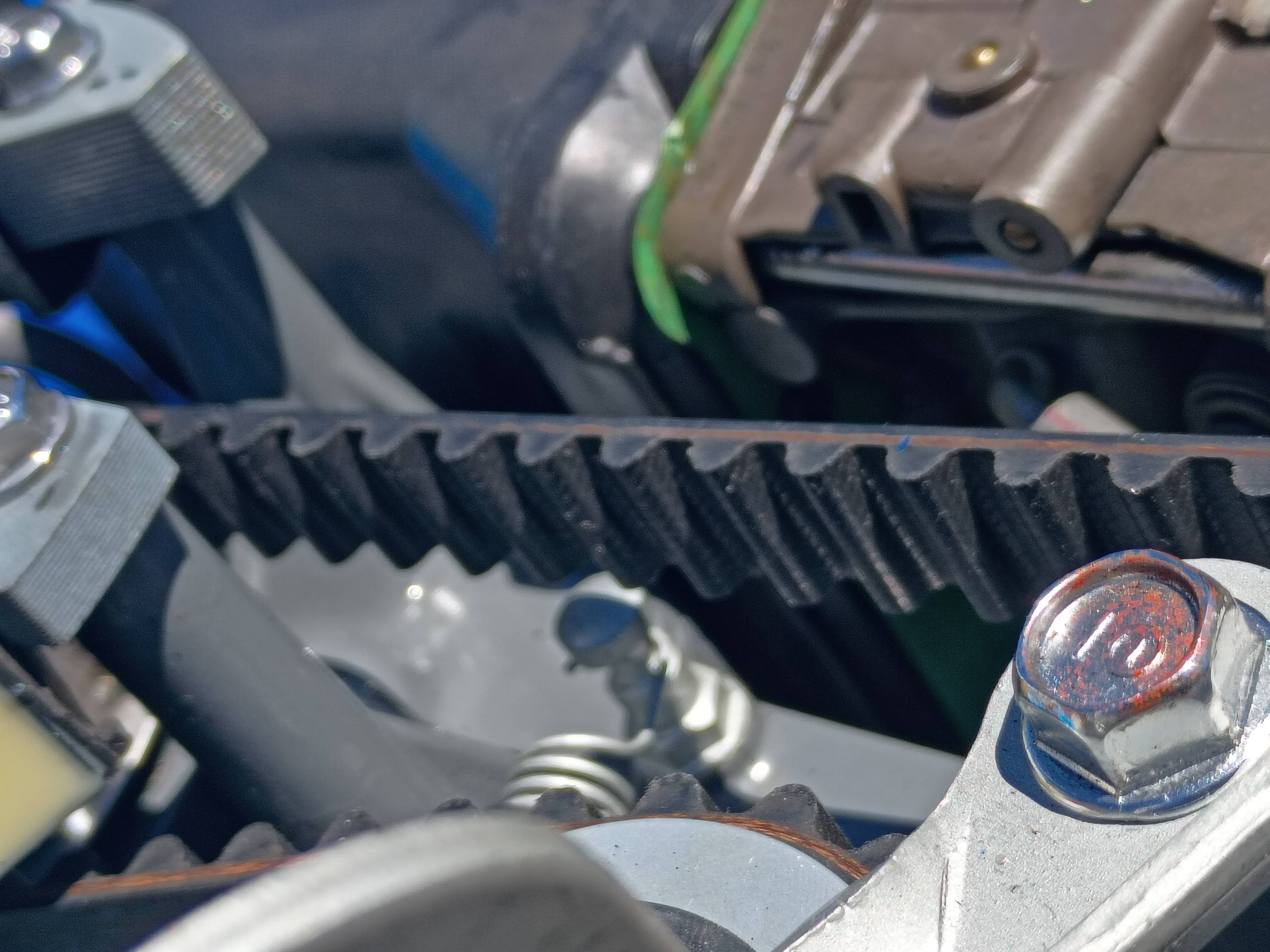

Agreed, prob Original belt.

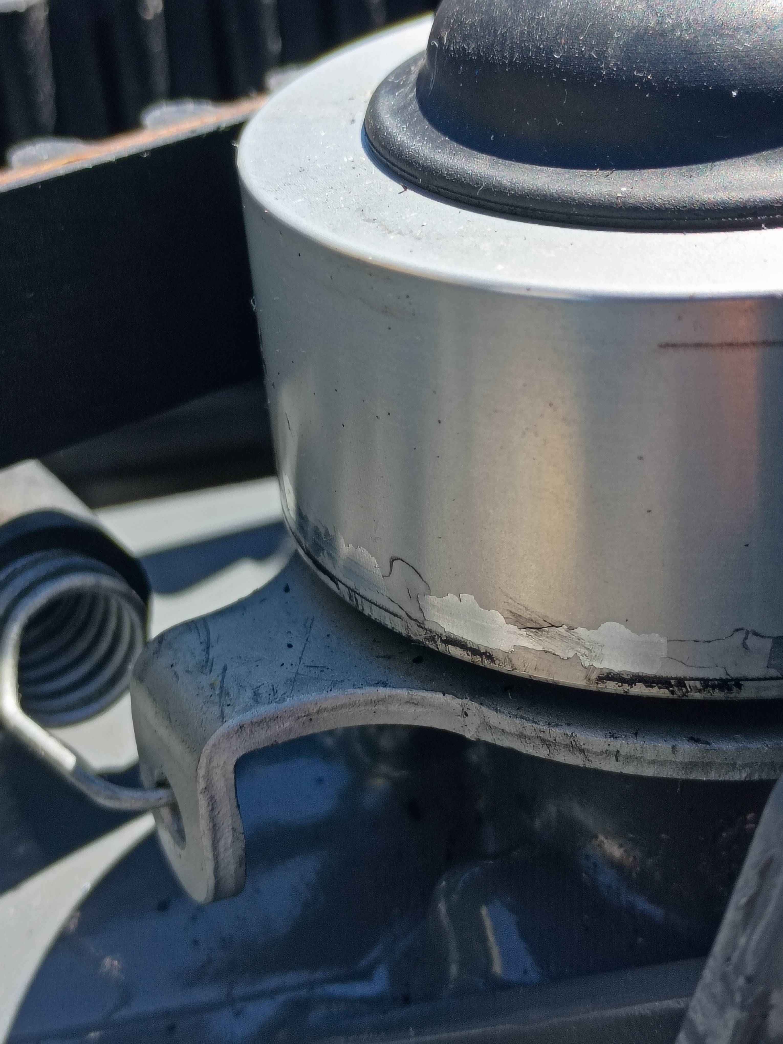

I had first suspected tensioner making the noise, can see some oxidation on tensioner chrome.

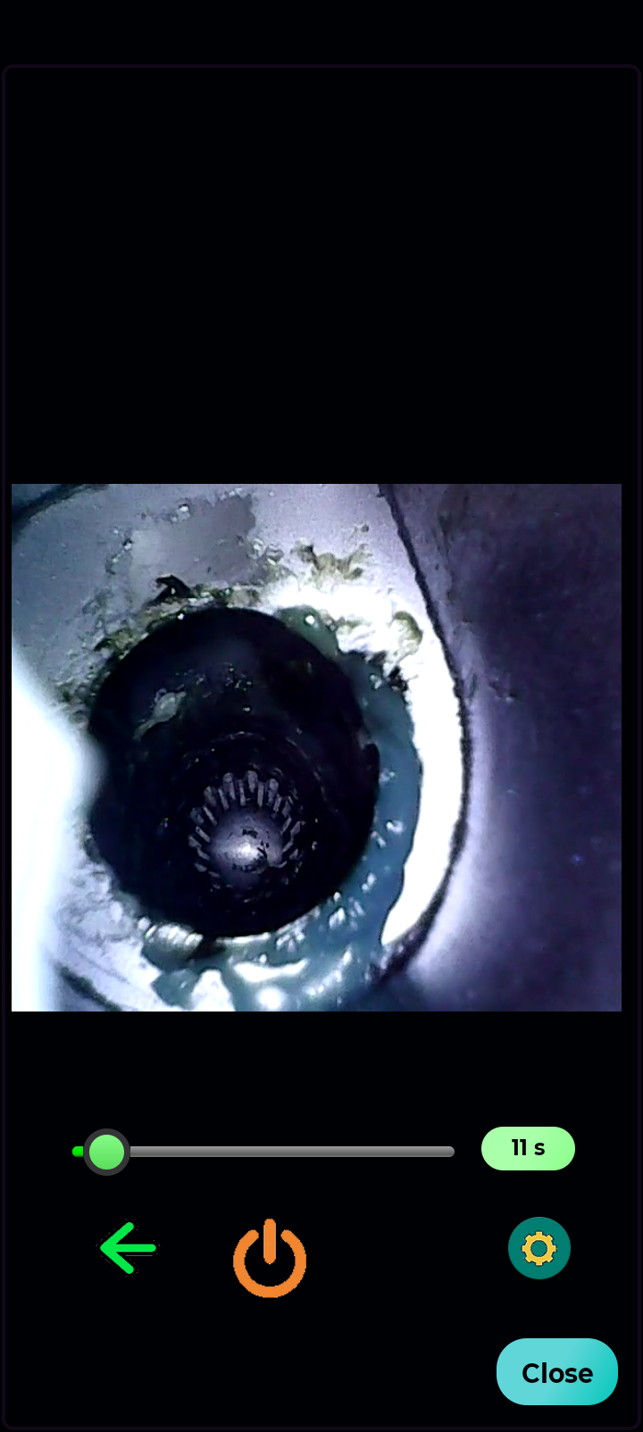

I also used endoscope to examine, pretty cool app for a phone
Removed lower and ran w water tube connected to hose.
Noise still present, so I was incorrect on the noise disappears, it seems I Lil bit less with shaft disconnected though.
Got a endoscope shot, can see the case before female end.

Well, I am stopping for now.
After grinding off material on magnets andDone w flywheel coils, l used marks a lot black felt pen, testing with lower unit off, the flywheel is not contacting coils or anything else.. I also carefully cleaned flywheel of any material that could interfere with engineered tolerances.
I also shimmed the coil mount holes to attempt pulling coils back from rotating flywheel.
