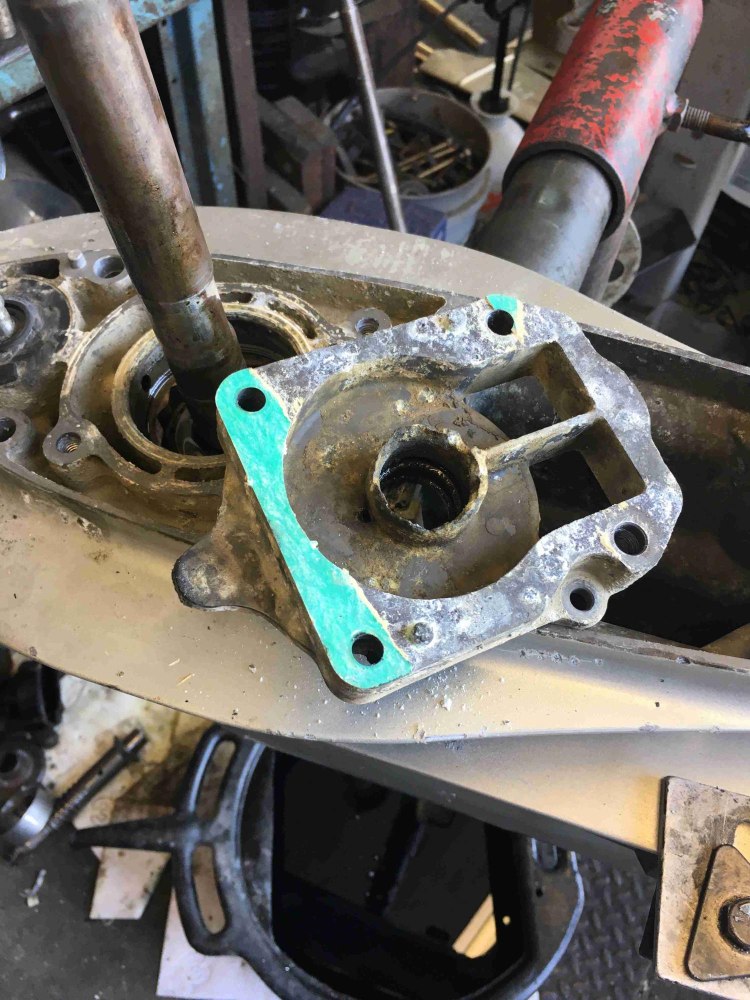

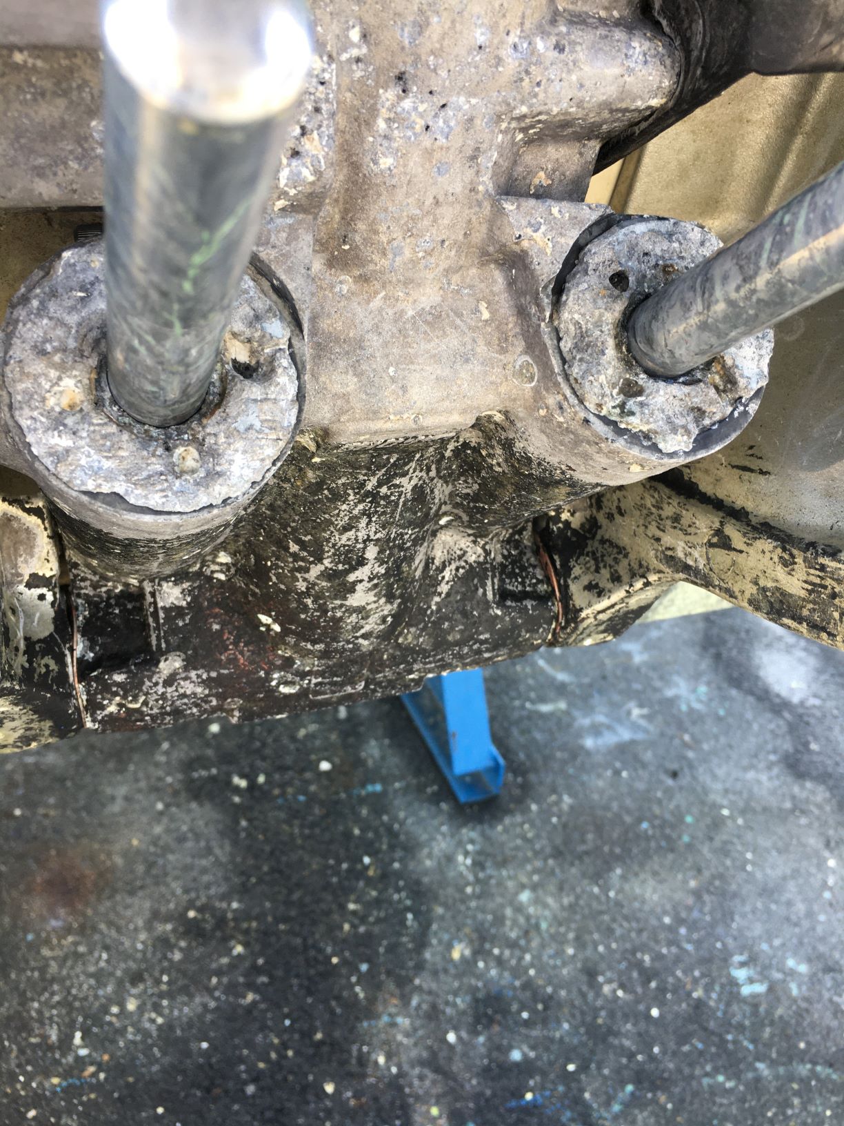

Turns out the temp light is no longer working - was when we had it inspected before purchase. The mechanic is replacing the impeller to start - thinks it might have sucked up a bag or something and burned out OR was put in incorrectly by the former owner. We will start here and see how things go.
We are replacing the following ...
water pump kit
lower seals
trim system
see attached pics ... likely the culprit of the sustained alarm and overheating?? I hope!!
The rough idle after alarm is what Honda’s do to keep from heat damage to engine. Sounds like a Descaling of cooling system is needed if current work doesn’t solve issues.
Looking at you trim unit, I would definitely drop the extension case/ trunk and check the grommet where the water tube enters the oil pan casting, I am sure you'll find it needs replacing
