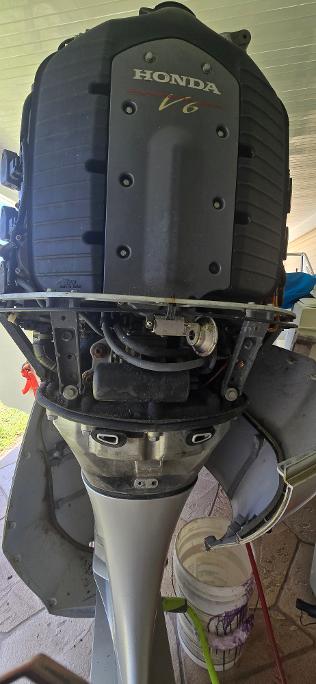

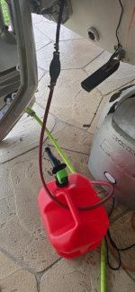

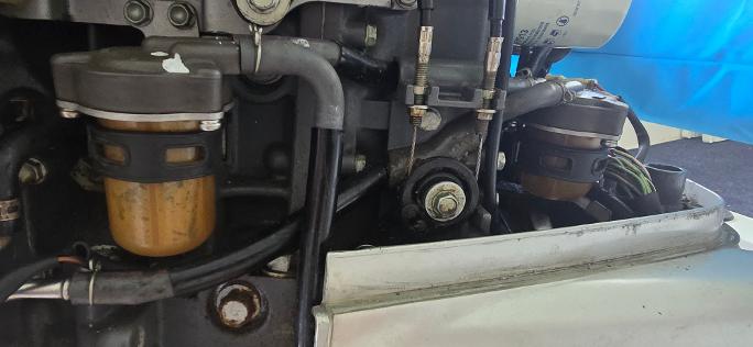

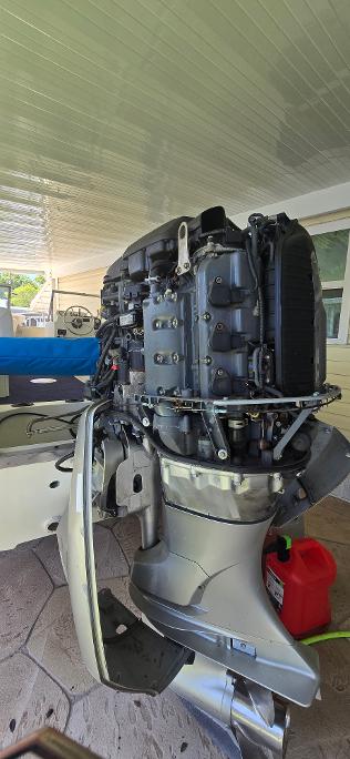

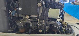

I have a 5 gallon can of fresh HIGH Octane fuel. I emptied the water separator and the fuel filter bowls and the lines leading to them from the priming bulb. The old fuel had almost no fuel smell. Do I need to empty the old fuel further toward the engine block or will that do? I have the lower cowling off and can get to almost anything I need. I have a 5 foot hose to attach to my priming bulb and drop into my portable tank. I am ready to give it a shot.

That filter in your last picture looks dirty? Replace all filters, then see if it will run on your fresh fuel.
Be very careful with having an open gas can, as opposed to a portable marine fuel tank with closed connections. Got anyone who would lend you a portable marine tank?
