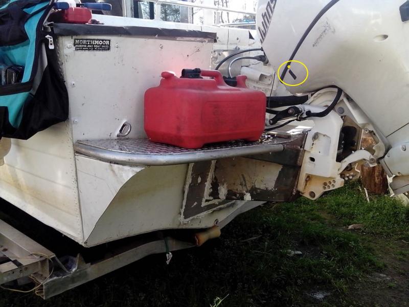

more bad news about broken engine pieces now the engine trim buttom is jammed on in the lowering position.
I circle the part.

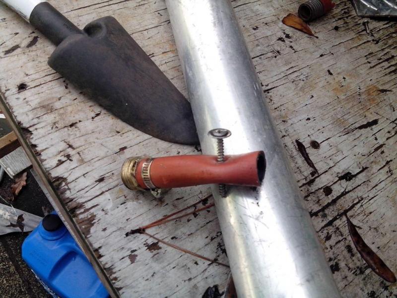

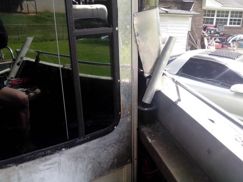

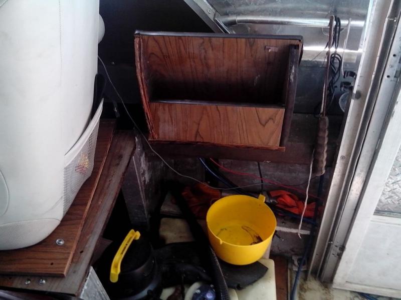

Update few images.

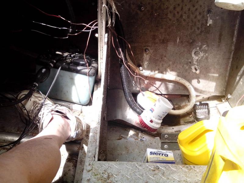

Finished the physical hardware of the secondary bilge sys. The 1500 Rule. Installed the discharge tube same height as the primary bilge, I had intentions to clock the primary auto matic floated switched 750GPH.
installed 2 additonale rockect launchers will use for the extra large net and a smaller bait sabkie rod.
Finialley my fourth season w/ the cruiser. Just got around to a helms station cozy/drink holder if you only knew how much drinks where spilled not a lot some it basicalley a piece of lawn chair vinale straoe rolled up and rivoted into place.
The thisn’t a bottom of the drink holder so the cuddies door will remain open during use.
Also started to mount my fish beater until the crumie harbor freight whole saw mineral took a dump.

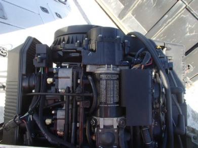

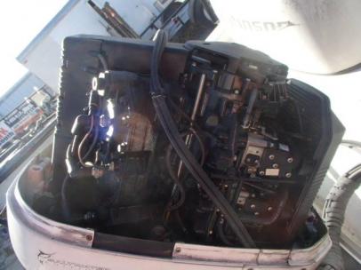

Doe’s my engine have a fuel fliter
I've been researching and read the manuel also I don't see a fliter on the Johnson
Thanks for any advice
OK I look for it. thanks for excellent advice as usale.
I've been reluctant to address any fuel related issuse it's just a nasty job that has to be sorted out properly.
