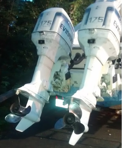

hello I am a new owner of a 2004 Johnson 175HP hopefully a proud owner.
I am getting close to completeing my project 1977 22' StarCraft Cheiftain
here' images of the Johnson

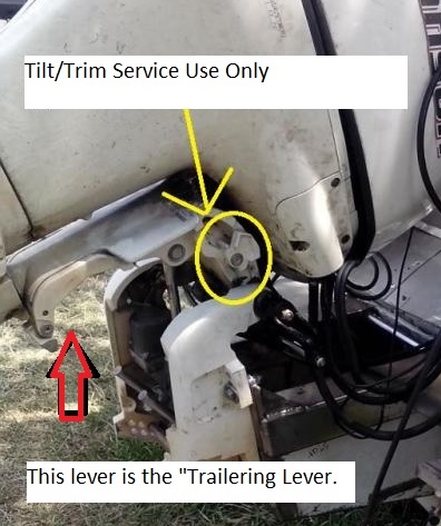

I disagree as there is more force applied to transom when boat is running and trimming than bouncing on tilt lock. That's what factory put it there for.
I thought it was supposed to reduce pressure on tilt & trim hydraulic pistons after raising motor,setting tilt lock, then lowering engine a bit to relieve stress on that system!
That is only when you are working on the tilt/ trim to service or remove/replace the unit. Never use that for a transom saver when travailing. When my engine is tilted in the water I use it just to help with the pressure on the tilt piston but only if I am not going to use it for a few weeks.
