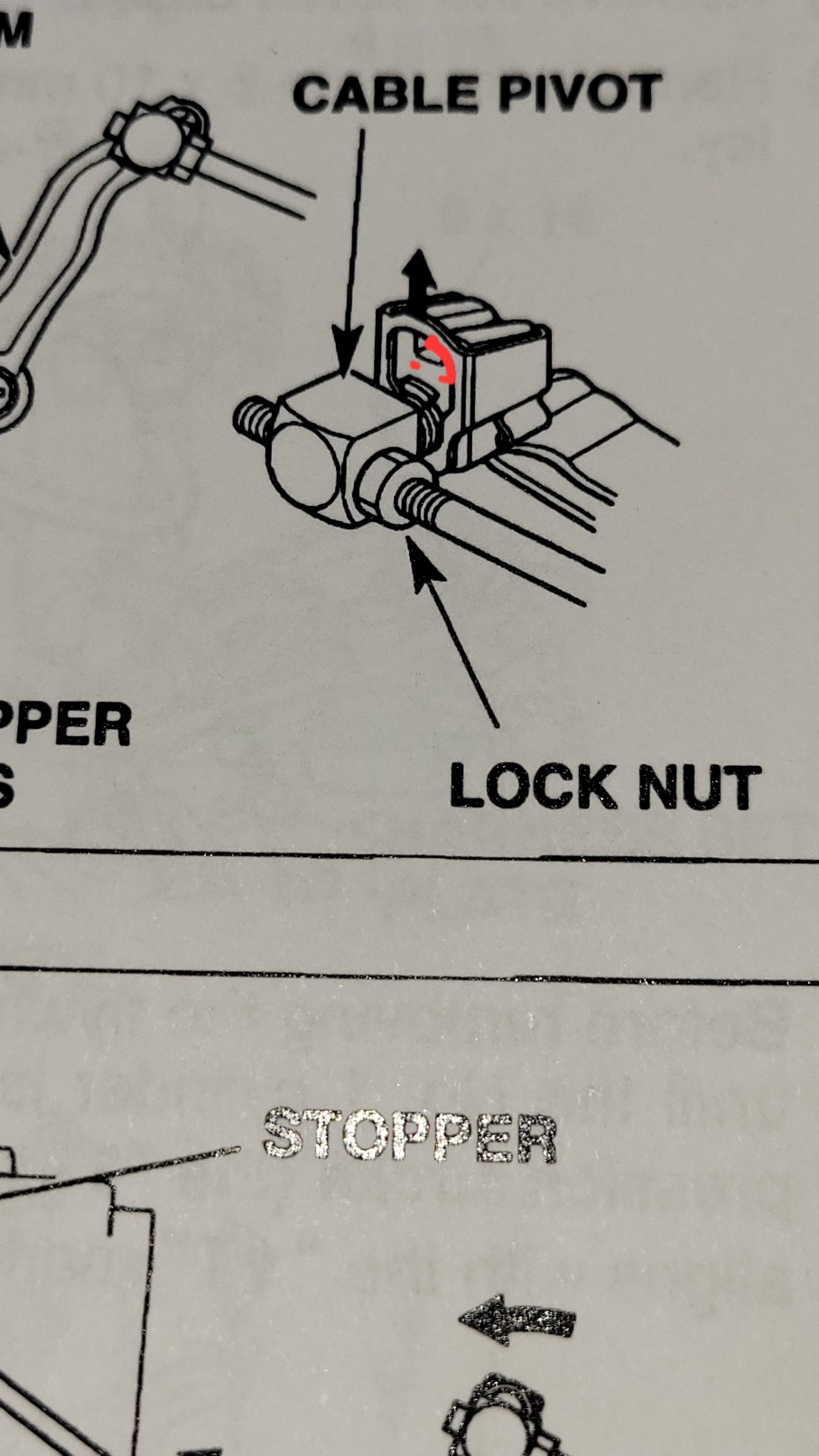

But I think that you may be saying that the CABLE PIVOT, on the carb end keeps jumping out of the throttle arm??
If so, there is a "plate" that locks it in place. See the part in the attached pic that I have partially marked red.
If that's not it then a photo would truly help me understand what you're trying to explain.
That's the one!!!! The little ferrule is secure on the control cable and lock nuts are tight ..the shaft slips in with no issue BUT also slips out ..it must be the plate that's not locking it in ..Will check today and thanks!!!
Great!
That lock plate should have a slight arc or bend to it in order for it to act kind of like a spring to help keep it in place.
If it has gotten "flattened out" for some reason, you can often just put a little bend back in it so that it will stay in place. Just try not to bend it too far and accidentally put a crease or fold in it. I think I did that once and I don't believe that they sell those separately.

Thanks mate ... hopefully the plate is still there so I'll check that. My cables coming from the SE valve are difficult to mix up as one has a male connector and the other has a female connector ..if there is no voltage measured then I would expect that I haven't pushed the connector together correctly as they were previously working fine!!
Further update regarding the Cable Pivot. On mine the brass fitting that extends and goes into the throttle arm has a sorta brass collar at the cable end and obviously the thinner part of the brass fitting slips perfectly into the hole in the throttle arm (but as already mentioned it slides out just as easily . Am I correct in assuming to prevent the fittings parting company, the slightly bigger diameter part of the brass piece goes BEHIND the throttle arm plate so it cannot pull straight out?? It was getting towards dusk so I wasn't sure if the metal plate slides off the top of the throttle arm and then you drop it down so it's over the brass collar??? Mine seems to have slots in the plate that would easily slide over the brass piece and prevent it slipping out.
It's been some time since I messed with one of these so I don't remember exactly how the lock plate engages the pin I'm thinking there's a shallow slot in the pivot pin but that might not be accurate. Look at it closely and I know you'll figure that part out.

Hi jgmo
Sorry for the delay but I figured out the plate eventually . My plate is a 3 sided one that actually slides up and down on the inner throttle lever. The front part of the plate (left side looking from the rear of the motor) has a keyshape cut into it so the brass bit complete with it's collar goes into the wider part of the lever. What you need to do is push the brass piece all the way in and then with a pair of pliers lift the plate so the narrower section connects with the slimmer part of the brass tube and that locks the collar. The cutout is very similar to some picture frames that have a wide section that allows a screw head to pass thru and then the narrow section locks it in place. So that solves that issue!!!!! The motor starts easy and still runs for around 30 seconds and then starts to splutter and eventually dies and won't start again ..my multimeter wasn't at hand but I did push the connectors together and push them into their plastic/rubber slots. Should the SE valve voltage come in fairly quickly as the motor starts great and within say 15 seconds starts to lose revs and eventually dies??? The needle in the SE valve had quite a lot of orange coloured "resin" on it so it MIGHT be sticking!!! I'm assuming it's over rich as using the idle lever on the remote doesn't help as it's already way too rich.

Nice description of how the lock plate works. Your analogy to the picture frame hanger is spot on!
