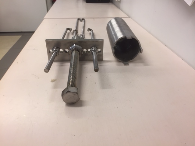

Hope the pictures work. I have made a lock nut wrench as well as a shaft holder puller. do I need to make a Prop shaft remover. I am hoping to leave the shaft in place and replace only the holder with new bearings and seals. Is this possible or does the shaft need to come out?

Nice tool fabrication! I pulled mine out a couple years back and made my own tools for my bf200. To answer your question if my memory serves me right, the prop shaft holder will come out without pulling the shaft itself.

No heat needed, just a nice even pull will do the job. If you are going to remove prop shaft then the gearshift shaft needs to be removed before shaft comes out.

After three days of heating, pulling, drilling and bashing I have finally this afternoon successfully removed the gear case bevel. I had too drill and collapse the lock nut as Bobmech suggested once I had that out I could see that it would never have moved the amount of salt and alloy corrosion was a lot. then came the gear case bevel jesus that was not moving for love or money i oiled it heated it cooled it heated again many times. I had so much tension on it the stainless 8mm pullers I made were straightening out. It got to the point that I was looking at new motors online. The gear case and i got to the point of all or nothing I bashed in the outer ring get that out of the way oiled it once more & heated again. wadda ya know out she popped. My gears and dog clutch have only the slightest sign of contact/ wear there is no rust or water sign in the gearcase everything is that grey brown colour of new parts. Bearings were as good as new but I have new so will use them. I have to do the paint work again but honestly thats nothing compared to having to scrap my motor because of a couple of dodgy seals.
