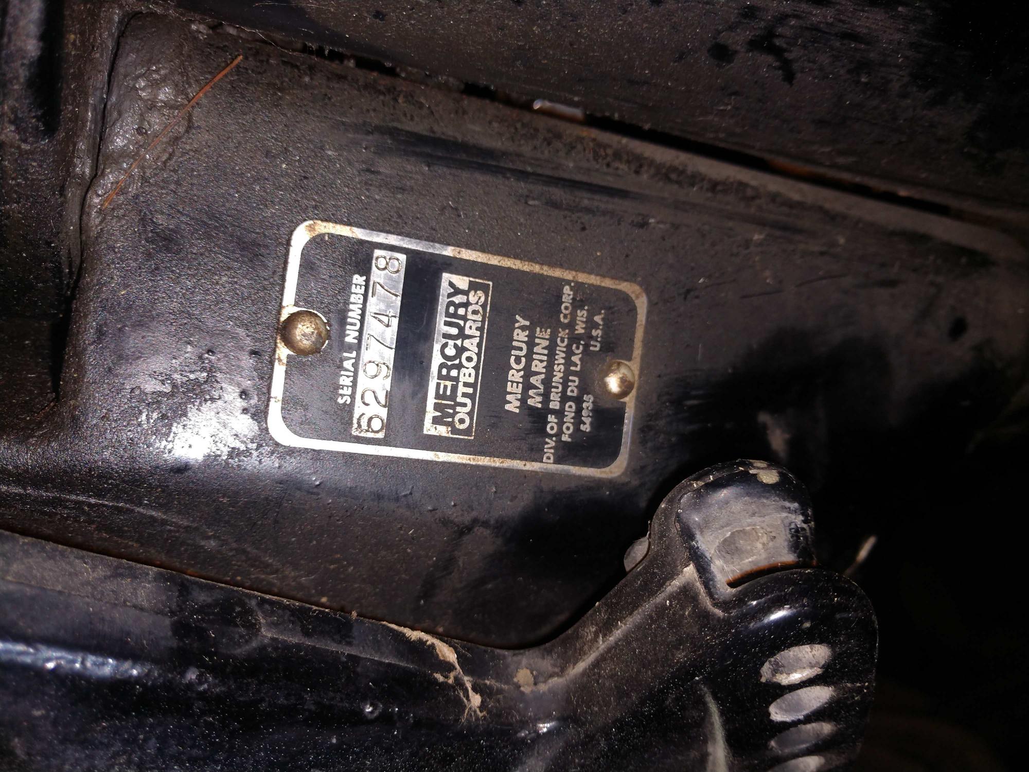

Here are photos. Top shows SW. box, middle is ID, bottom is timing base......not sure why the photos were rotated, that's not how I entered them....sorry.

On my motor the bottom wire was attached so I think it's good where it's at.
The top and middle wires were just hanging loose on my motor.
So are you saying that the top two wires go to a on/off switch?
The brown wire and the white wire go to trigger coils under the flywheel.----And one wire from stop switch goes to ground.----The other wire goes to the same terminal as the orange wire I believe.----Looks to me the previous owner could not get spark and did not want to spend an arm & leg for parts.
