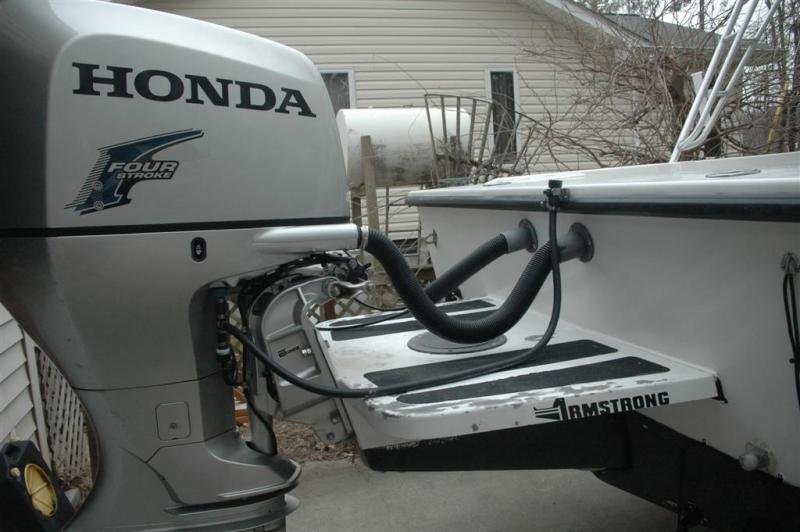

I quickly found that it was a PITA to constantly unscrew the flush port from it's base and attach a garden hose to the flush port. This was especially troublesome since I keep my boat on a lift most of the time. So I built a bypass using a T connector to run a flush hose to a snap hook on my transom, and there I installed a quick-disconnect hose fitting and a on-off hose valve. I'll try to post the picture, but if that fails, send me an e-mail at [email protected]
Nice idea for a boat on a lift for sure!
I'll have to order that little seat, I believe the piece that screw onto the hose fitting is missing this, and that is why it leaks.

Hey chawk!
Now don't take this the wrong way...(or anyone else, please) but I just had to say.......
.....WHooo whoo (wolf whistle)
Nice lookin' transom there fella!
Jimmy - great to hear you're still monitoring this forum, and great to here from you. That transom has been refurbished and repainted since that picture was taken. It really looks good now.
