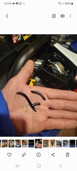

The little fuel tubes are made of inferior materials. I replace with tygon silicon....expensive, but a permanent fix.
Motor mounts, 9.9/15's. Nice, eh? How bout this new chainsaw. Yes, new.... The retailer must have test run it with ethanol. My brother won it in Miami at some sort of a raffle. Ha! Squeeze bulbs deteriorating from the inside out.

That fuel hose needs to be outlawed. This cost me a serious delay in late October, years ago, trying to get to our camp in NW Ontario. If my customers produce this hose on their fuel supply, they get it replaced. I ALWAYS, ask them to bring the fuel tank that they have been using. Often the plastic versions have leaked in water as well. Pontoon boats, with exposed plastic tanks are about the worst. Here is one of my customers. Pretty cool set up. He owns a trucking company, this was built by himself personality, all from scratch parts. Had a Tower of Power Classic Merc 90. He went modern Yamaha. Sounds like a sewing machine. The Tower is on my old Alumacraft now.
