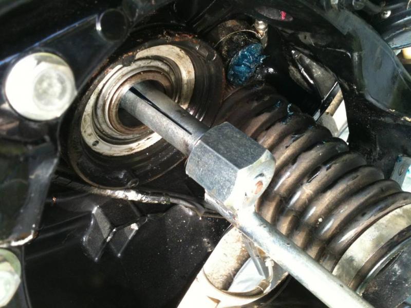

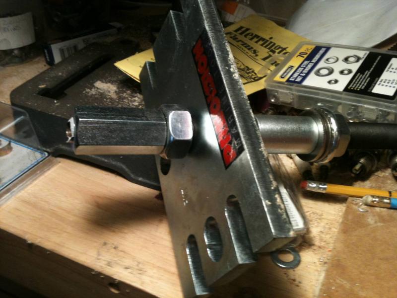

Use the axle puller thru the bearing use a spanner across the opening with a threaded rod and slow and steady pressure you will get it out.
Any other puller with a spanner and screw will do with the axle puller as long it spans the opening capiche ?
Don't use a slapper.
