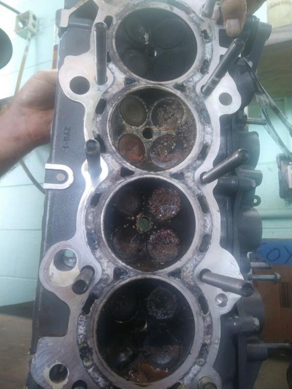

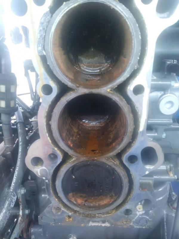

I still haven't heard from the District Service Manager. I did go and look at the motor. There was water intrusion into cylinder 2-3-4 and #1 looks brand new. I've attached 2 pics, the gasket as you can see did not fail........i have no idea how water can get into cylinder 2,3 and 4 and leave #1 looking new. The boat didn't sit in the water and the motor wasn't trimmed up. After they picked the boat up, it sat at the shop for about 2 weeks before they got into the motor to tear it down - so i don't know if it's possible that this much corrosion occurred in that period or not. Any opinions?? IMG_2484.jpgIMG_2485.jpg
That's seriously UGLY! The only thing I can think of is a cracked or open water passage in the block, likely due to a manufacturing fault. If it was in the head, it would be obvious. See Jimmy's post #9.
What's the shop think caused it?
Chawk Shop doesn't know what caused it - they said the block looks great - no issues - no issues with gasket or head - they think it could be an internal failure within the block - but nothing to see externally..........Honda District Service Director is suppose to contact this dealer.....I'm being told...........the amount of damage/rust within the cylinders I presume is from sitting at the dealership prior to a tear down - I have no idea how it could've caused that much damage.....

I still haven't heard from the District Service Manager. I did go and look at the motor. There was water intrusion into cylinder 2-3-4 and #1 looks brand new. I've attached 2 pics, the gasket as you can see did not fail........i have no idea how water can get into cylinder 2,3 and 4 and leave #1 looking new. The boat didn't sit in the water and the motor wasn't trimmed up. After they picked the boat up, it sat at the shop for about 2 weeks before they got into the motor to tear it down - so i don't know if it's possible that this much corrosion occurred in that period or not. Any opinions??View attachment 15946View attachment 15947
Those pics make my stomach hurt!!!
