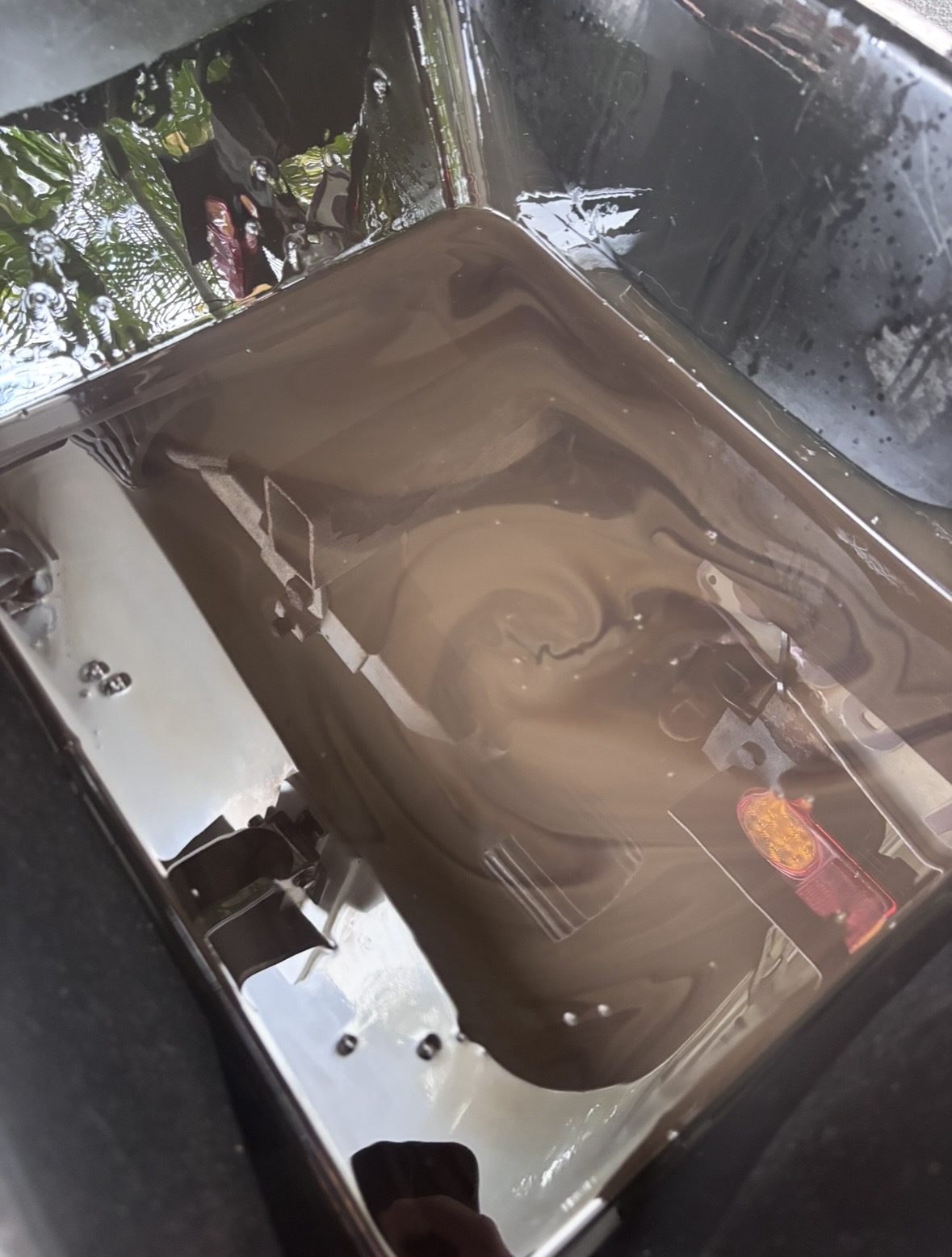

I have a 2014 Honda bf60. I have just recently completed my annual service on it and have noticed the engine oil looking milky once drained into the pan.

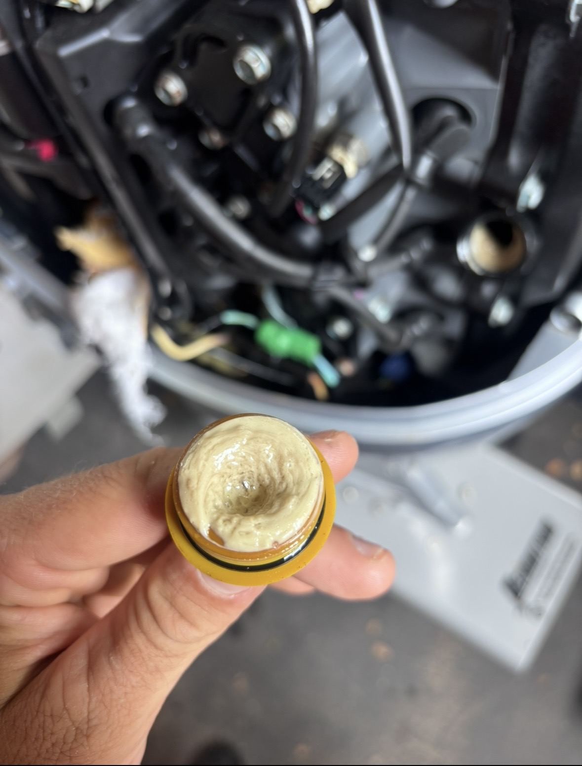

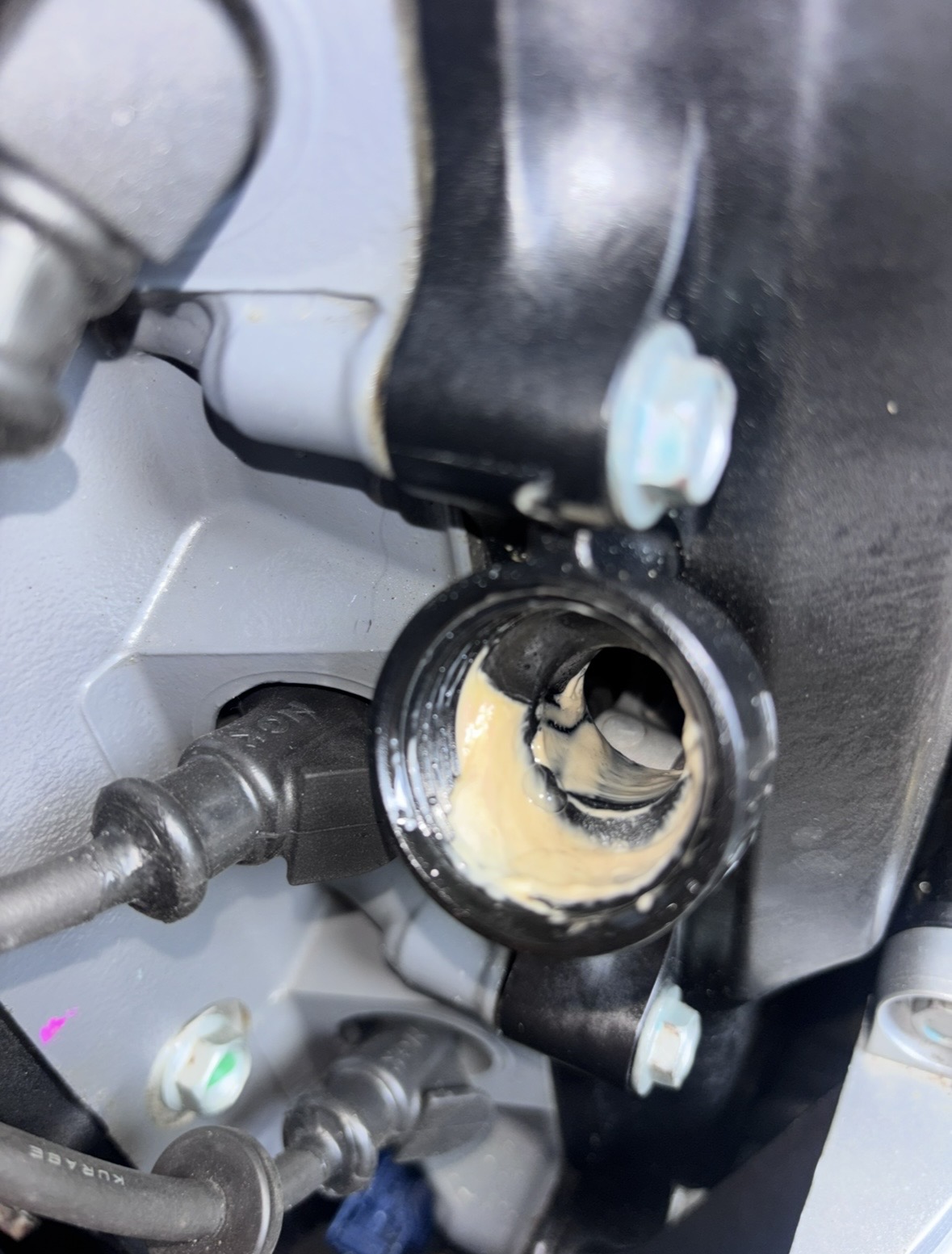

Once I removed my filler cap I noticed this sludge build up inside of it.

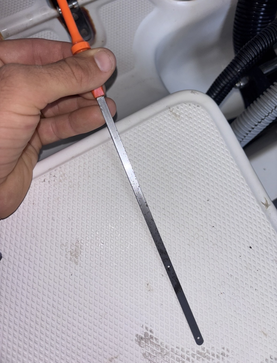

Also another little indicator I noticed is this weird markings above the oil line on the dip stick, guessing from salt water Vapor potentially?
Would I be right based off of this that water definitely has somehow entered my oil system?
And if so has anyone experienced this issue and may know where it has potentially come from and what was the resolution and outcome for the outboard?
I have heard there is a seal that commonly goes on bf60s around this age that can let water into the oil?
Any help is much appreciated.
Cheers!

Hi,
I honestly don't know. I have never worked on a Honda 60.
That does look like water intrusion though and it doesn't look good to me.
When I was first reading your post, I was thinking "maybe a cold running engine due to a stuck open thermostat". But then I saw the pictures you posted and it looks like too much water for that to be the cause.
Again, I have no idea what the reason is but just wanted to point out that there is a close intersection of water seals to oil pump where the mainshaft comes up through the oil case and mount case. See items 2 and 28 in the link below:
IF that's where water is entering, I imagine the repair would require a major tear down with possibly the need to inspect/replace the oil pump along with other components like bearings that have been effected by the contaminated oil.
The only accurate advice I could offer you would be don't run it again if you want to save it. To which, I imagine, you say "no duh dude".
Sorry for the glum take on things but it's how I see it. I hope I'm wrong and it isn't as bad as that.

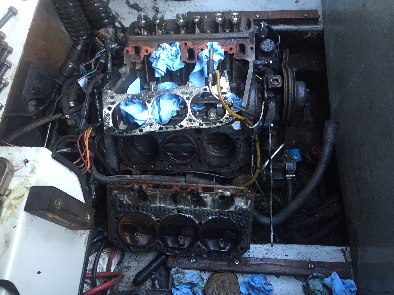

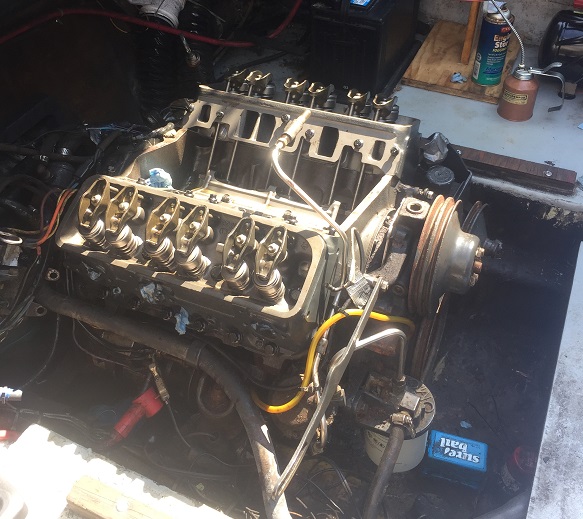

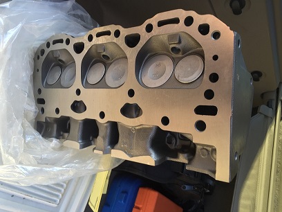

I agree with this response, that is a lot of moisture. When my old 4.3 looked like that it was 2 leaking head gaskets. Repaired with a set of reman heads, new gaskets & head bolts and it’s been fine for 9 years since…
Thanks for this info. Where are you based and what was the cost to do this roughly?
Long Island NY, parts cost was $550 for a pair of reman Chevrolet 4.3 V6 heads, $120 for a marine head & intake gasket set and about $100 for a set of new ARP cylinder head bolts. So less than $800 parts cost plus my labor. But inboard engine parts are cheap vs outboards because they are just modified light truck engines.
started with this...
bought a couple of these
wound up with this
when I got it all back together it started instantly I was actually shocked.
