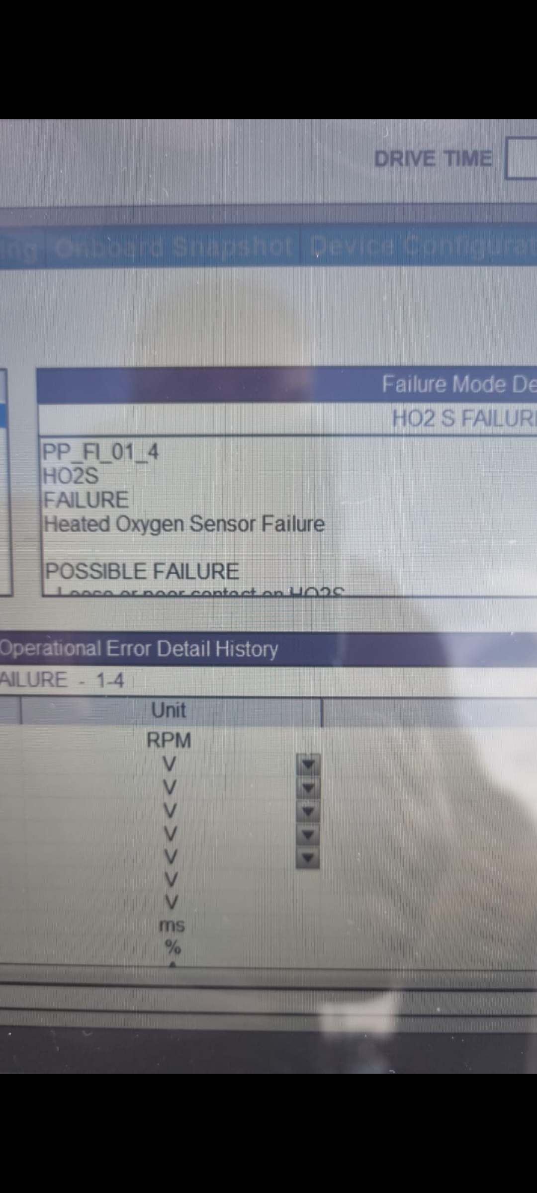

This is what Dr H diagnostics display
That's not telling you whether it's the sensor or the heating element that has failed. The shunting method will identify if it's the heating element (Code 41) or the sensor itself (Code 1). Closely check the HO2 sensor plug and the wires going into it. The two white wires are the sensor element, The other 2 are the heater element. Then check your 26-pin connector to the ECU. Specifically, check pin 22 which has a white/black stripe wire going into it. That's the power source for the HO2 sensor. Make sure the pin is not recessed or corroded. If you can back-probe it, it should read 12 volts when the ignition is on. All of this is gleaned from the shop manual.
If nothing there, it's possible that the replacement HO2 sensor was bad to start with.
