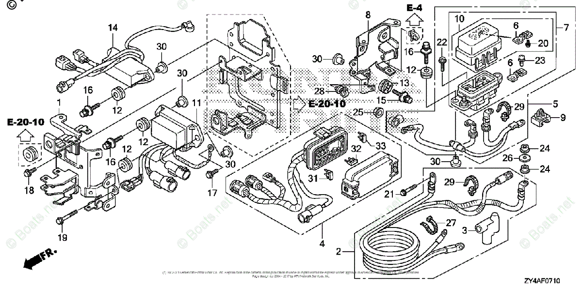

Thus replacing this 'Honda Main Relay Assembly 06380-ZY3-000'? Where is this actually located? In the very front part of the motor I suppose?

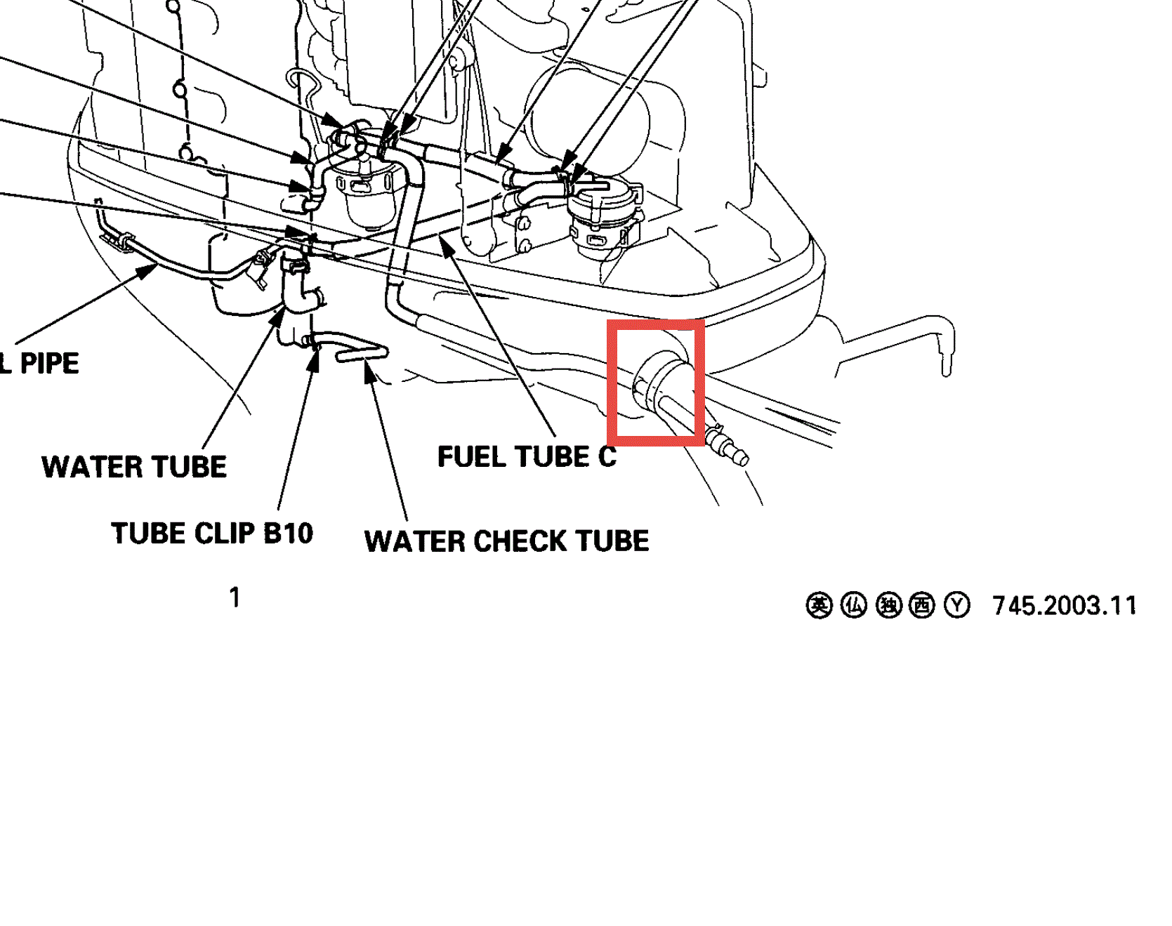

I suppose rectangled area below is in question?
Main relay is behind the black cover at the front of the engine, item 14 of the attached picture. Main relay has three sub relays inside, one for the starter, one for the fuel pump and one for the ECU, injectors, sparks, etc, but it is an assembly and is only one part, just good to know for troubleshooting and measurements...
Fuel, yes, just follow from engine conduit entry to the water fuel separator found on the fwd starboard side. It goes through a grommet and also metal corrosion bulges and squeezes the tube.

Thinking of getting Main relay replaced. Now Boats.net price for part being 70USD and local Honda dealer's importer price over 300USD thinking which one to go: Boats.net partno 06380-ZY3-000 against Honda dealer partno 38580-ZY3-013. Found information 'Honda 38580-ZY3-013 Superseded by 06380-ZY3-000 - KIT,MAIN RELAY' thus suppose same/corresponding part is in question and 06380-ZY3-000 being so called 'after market' version of the original one? How should I consider them technically and quality wise - are there clear differences other than price? Any experience of Boats.net parts?
Secondly earlier in the Boats.net screenshot by Blacktimes the part is displayed as no 14. According to my serial BAGJ-100xxxx I find Boats.net diagram for 'Start cable' where part is displayed as no 17 (https://www.boats.net/catalog/honda...in-bagj-1000001-to-bagj-1099999/starter-cable) https://www.boats.net/catalog/honda...in-bagj-1000001-to-bagj-1099999/starter-cable and part itself being 06380-ZY3-000 (https://www.boats.net/product/honda/06380-ZY3-000?ref=f3b03e4e76584d0ec3a1383d15744b9e8fdc97b2) https://www.boats.net/product/honda/06380-ZY3-000?ref=f3b03e4e76584d0ec3a1383d15744b9e8fdc97b2 . I suppose the earlier diagram was only an example taken of different machine?

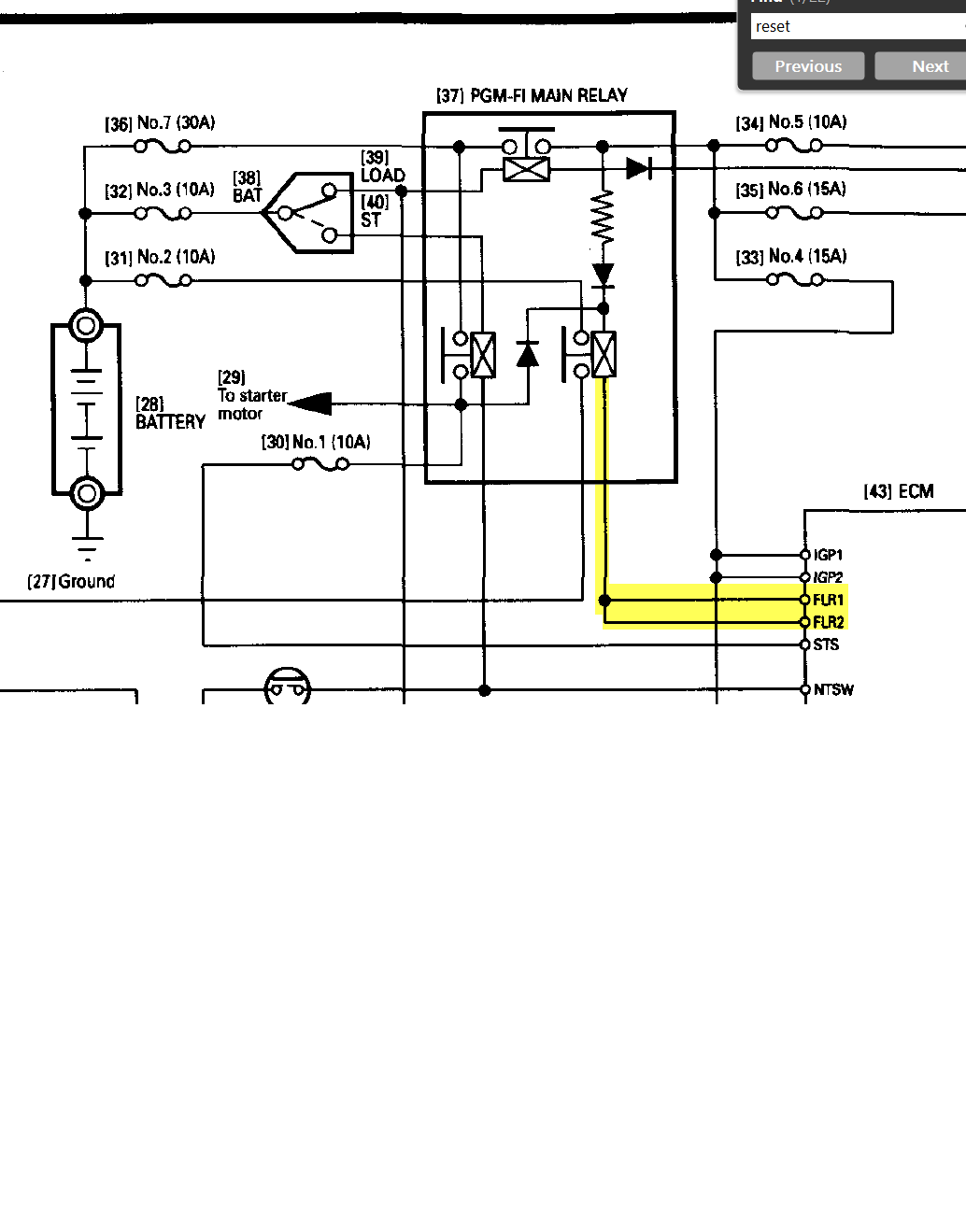

It seems that PGM-FI main relay's fuel pump subrelay gets no control signal from ECM (FLR1 and FLR2). Any tips what might be prerequisites for ECM to drive full pump relay?
In addition ECM was reset to make sure no ongoing fault would prevent it to control PGM-FI main relay.
FLR 1/ FLR 2 provide a ground to the coil of the fuel pump relay. Why not try a ground to a flick switch to the relay and close the circuit while trying to start the engine, see what happens...
But I understand we should rather know what information/control signal(s) ECM needs to control (give ground) for full pump relay?
Yes, correct, but you can work it either way, either find the logic for pump activation or do a quick bypass and see what happens. From what I see on the attached, initial ECU gives a 3 sec HP run for self test and maybe priming purposes. Then main relay, sub relay, left hand, starter, also energizes HP sub relay, middle) via left hand diode, and after starter disengagement, HP sub relay, middle, continues to be energized by right hand sub relay, ECU, injector and ignition relay. The starter relay, which also affects the HP relay is also conditioned by the neutral switch. But if you have starter available, forget the neutral.
I´m starting to suspect that you hay have an ECU issue or ECU wiring issue.
Thanks very much for clarifications. I suppose the attached diagram is applicable also for my BF225A manufactured 2003 (BAGJ-100xxxx)?
