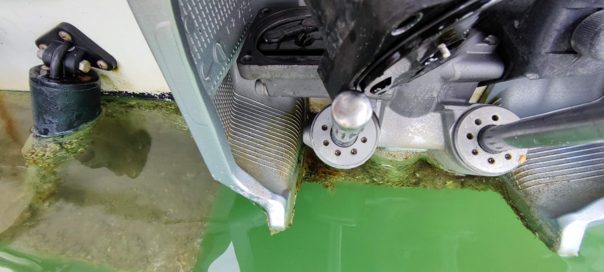

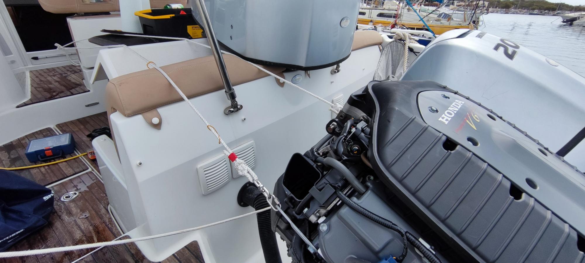

Just to confirm that the Tilt Motor can be replaced with the boat in the water and without having to disconnect the engine from the tilt actuator or removing the left side of the bracket. You will need a paddle board or something similar to sit on the water and that fits between two engines if you have twins. The famous left hand forward bolt that sits right next to the bracket can be removed with a 1/4 inch wrench set with a cardan, different length extensions and a PH2 bit. Engine was secured with rope to the attachments just for safety. here are some pictures. IMG_20210518_110902.jpgIMG_20210518_11083888.jpgIMG_20210518_110917.jpgIMG_20210518_115627.jpg
And yes, bottom is dirty and scheduled to take out of the water for cleaning and antifouling next week ;)
