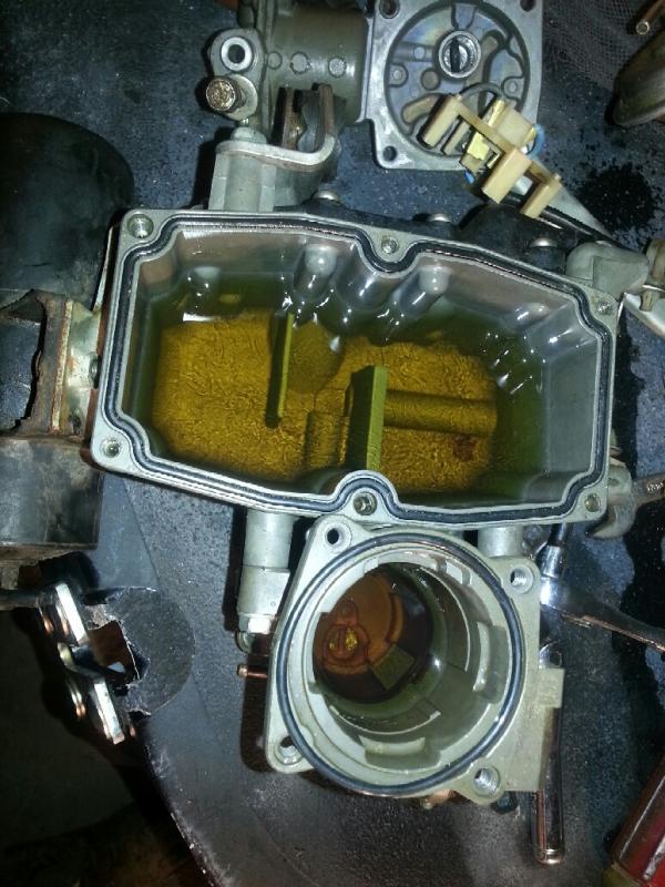

I have an '03 200 that has burned up 3 fuel pumps. I bought the motor used, so Im not sure if this was an issue before I got it. But since I got my hands on it, it has gone thru three fuel pumps. I have also replaced the vapor separator tank with a good condition used one. I have taken the bot out twice and both times I have had fuel pump failure. The scenario is like this: Saturday I was going fishing, (keep in mind I have a brand new high pressure Honda fuel pump), I start up my engine and within a few minutes the PGM-FI alarm sounds. If I turn the engine off and on it will clear up for a few minutes once again. If I run the engine, it runs great and alarm doesnt go off. Well, I have researched this problem and apparently its the O2 sensor...(Im not sure if the O2 sensor is related to fuel pump??) Anyways, I ran offshore for about 30 miles with not issues other than the PGM-FI alarm sounding when I idle. For that reason I had been turning on/off that motor when I was drifting or needed to idle. Well, now Im 35 miles offshore and that particular motor did not want to turn on. Sounded like it was out of fuel. I squeezed bulb and was soft (was able to squeeze it 2-3 times). Engine still did not start. I came back in to port on my other motor. Upon my arrival to dry land, i checked the fuel lines and had fuel going into the vaport separator tank. I took off the bolt on the starboard side to see if there was any fuel coming out with key turned on and nothing! I could hear fuel pump humming, but no spray of fuel. Im at a loss here and would apprciate any help. I had also replaced the fuel filter in the VST and the inline filter and water strainer prior to my trip.
