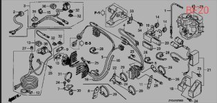

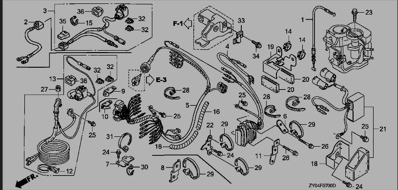

it's a tiller so I'm guessing there's more that I need to convert it over to remote. SmartSelect_20200811-121851_Samsung Internet.jpg
All right can it be done. I've looked at the BFP 20 and I see the wiring harness is very close to the BF 20's is it possible to swope harness. And thank you this is more help than I've gotten on this issue 20200811_153745.jpg20200811_153819.jpg
The boats.net Honda parts guide shows your frame number range as being a 2004. Not that it really matters.
What does matter is that Ian is right. This isn't an impossible refit but it's likely not going to be very cost effective.
