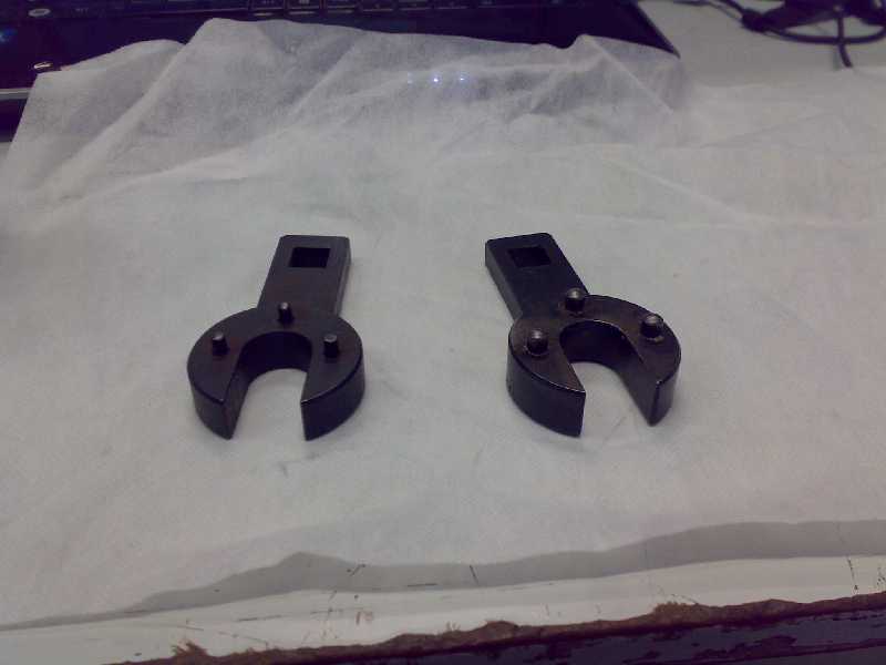

Doing a little more research, The tool #07SPA-ZW1020A is used to remove the "trim" end caps on the trim cylinders. #07SPA-ZW1010A is used to remove the end cap on the "tilt" cylinder. I have not been able to find a picture of either of these tools. Any one know of a picture? I originally thought if 2 of the 4 holes on the end caps were used (opposite sides) it would be sufficent, but now I'm wondering if all 4 holes in the end caps are some how used. The tool would simply have a large hole in the center of accomidate placeing it over the extended rod then using all 4 holes to spread out the torque from the wrench. I'm thinking of making the tool..
One more thing, every one is mentioning PB Blaster, is this the actual name, and where is it purchased. I have applied "nut cracker", which is probably the same thing???
Both the tools are similar shape, and they only use 3 of the 4 holes. I will take a photo later in the day when I have time and post it up for you.

Hope this image may help
Cheers
John
