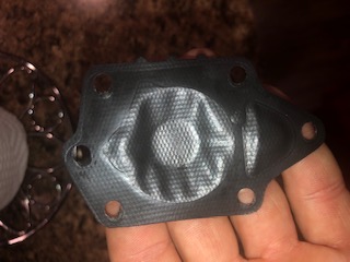

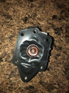

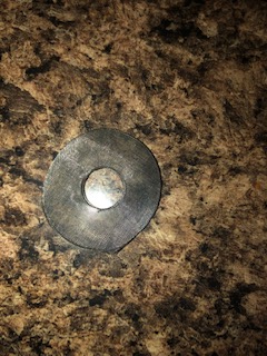

I see wrinkle in the fuel screen gasket and I also see some rust on the check valve reed bolts. What does the big diaphragm look like?

Beautiful photos, it's a gonner, brother. Stretched out from ethanol. Rust on check valve reeds too. It could be carefully cleaned and rebuilt but it will be more likely to rust again. Did you watch that Yamaha video? Ethanol and boats or airplanes, is not a good mix.

So looking at the pictures of the fuel pump would you guys say that was probably my problem? I haven't taken it out yet to see how it does. Thanks again!
I would say "problem likely solved". Let us know how she runs.
