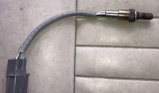

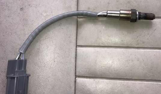

Stupid question #2: is the above part an oxygen sensor? On the honda website, it says the part number for the oxygen sensor is [FONT=&quot]35655-ZY3-C01
[/FONT]
But that number is not stamped on my part (which I assume is an oxygen sensor)... my part has 3 lines of numbers:
B22690
40203-00
3726
None of these turn up anywhere online.

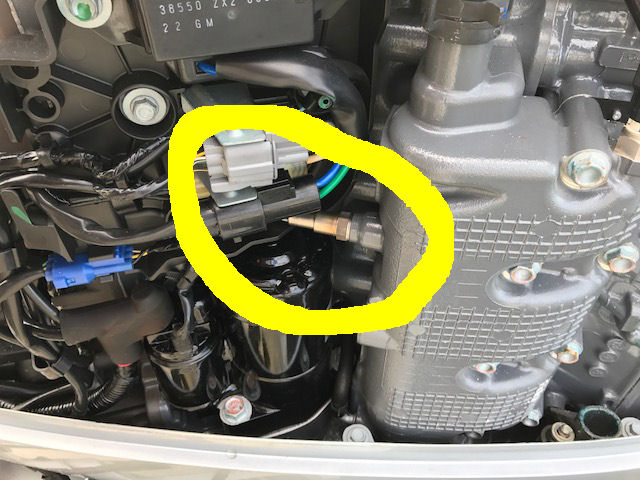

Could it have been the wrong part in my engine? I got it from the yellow circled area:
I'm looking at Honda service bulletin # 70. It says that new the HO2 sensor is part 35655-ZY3-C01, which is the replacement for the old (22 mm) HO2 sensor, part number 35655-ZY3-013. On Boats.net it's $207.
That is the right part number. I got a new one at a local store - it had the same markings - got ripped off but had it today. With boats.net they couldn't send it out until tuesday... didn't want to lose this holiday weekend.
I installed it and used it for 30 minutes with no alarms!

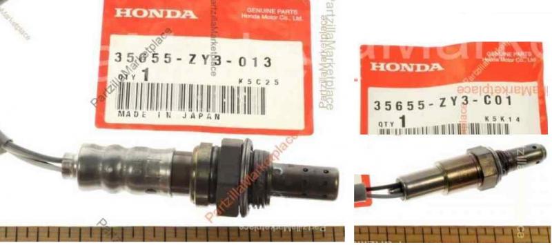

[FONT=Arial, sans-serif]had the same experience as you. On my boat from 2004 to 2012 I had a BF225 that never gave any HO2 problems, but on my BF 225 was mounted a 35655-ZY3-013 that is very very different from 35655-ZY3-C01 mounted on the bf250.[/FONT]
[FONT=Arial, sans-serif]If I can, I send the pictures to see the difference.
attachment.php
[FONT=Helvetica, Arial, sans-serif]As you can see[/FONT] the 35655-ZY3-013 has an M18 diameter like almost all oxygen sensors, whereas the 35655-ZY3-C01, which fails very often, has a smaller diameter M 12, unusual.
[/FONT]
[FONT=Arial, sans-serif]From the color of the 4 cables (white-white - black-gray) both should be a zirconium dioxide sensor, which needs a larger diameter because inside it must circulate the air to compare with the exhaust gases, so the small diameter M12 of the 35655-ZY3-C01 is very strange and could be a reason for the short duration.[/FONT]
[FONT=Arial, sans-serif]On my BF250 contacts, plugs, sockets as like new, the spark plugs and the coils are OK, the wires (white-white) of the HO2 that go to the heater are not interrupted and a resistance of about 10 ohms is measured, the motor runs well and it does not lose strokes, but has the same symptoms described by bigfoot3.[/FONT]
[FONT=Arial, sans-serif]The faulty HO2 (I saw 5 of them) are not blackened, they are like the one posted by bigfoot3.[/FONT]
[FONT=Arial, sans-serif]Replacing the HO2 the fault ends, as happened to bigfoot3.[/FONT]
[FONT=Arial, sans-serif]The problem is that after a more or less long time returns, in my engine the HO2 lasted 18, 34, 40,73, 195 hours.[/FONT]
[FONT=Arial, sans-serif]I think this increase in sensor life is not random and that Honda is trying to solve the problem but it still hasn't solved it.[/FONT]
