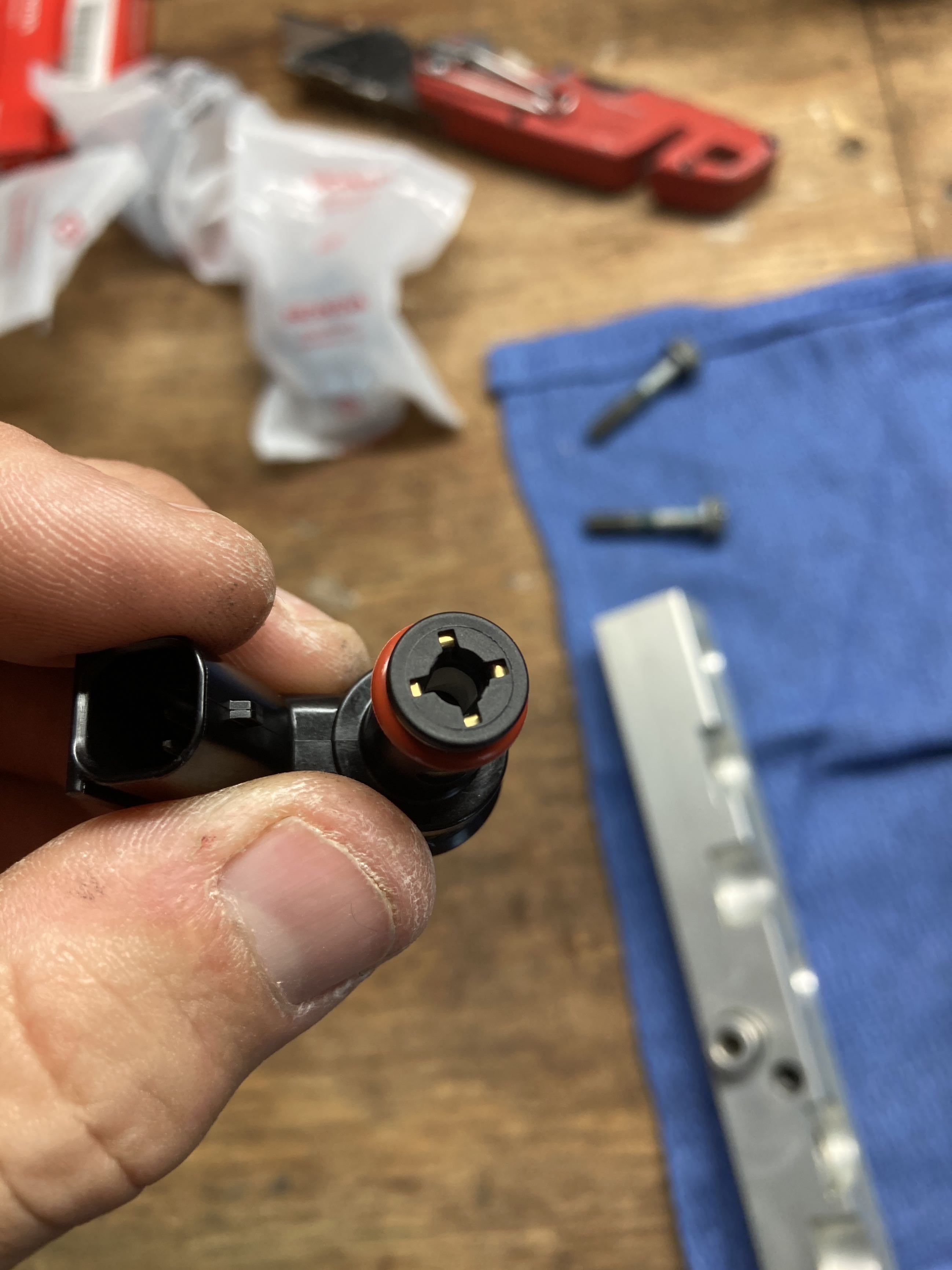

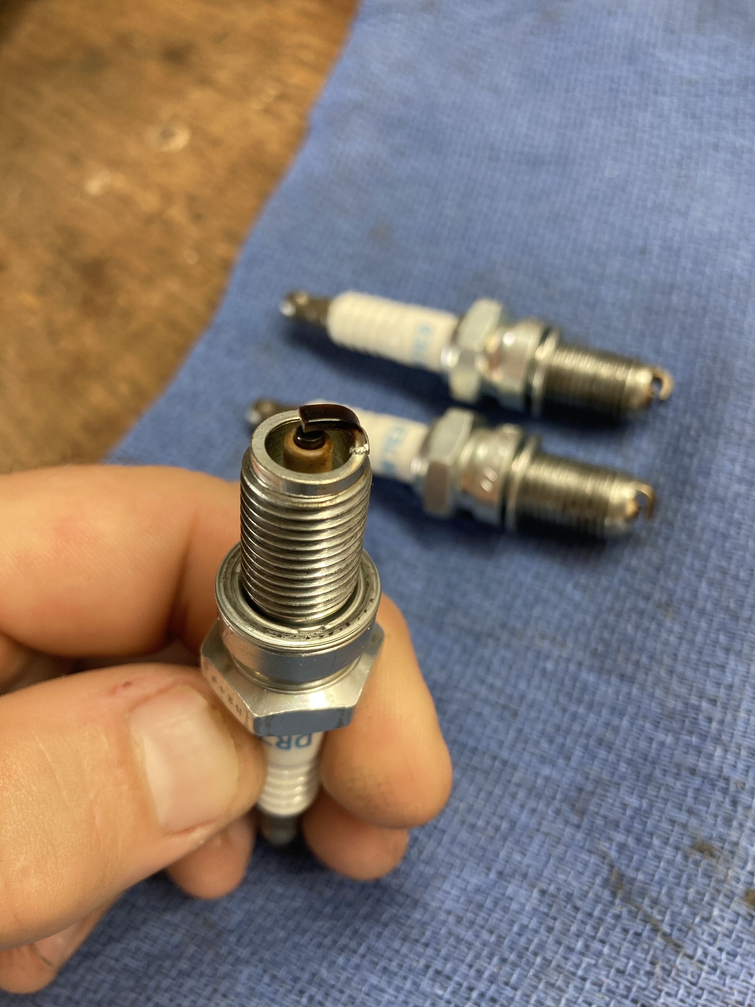

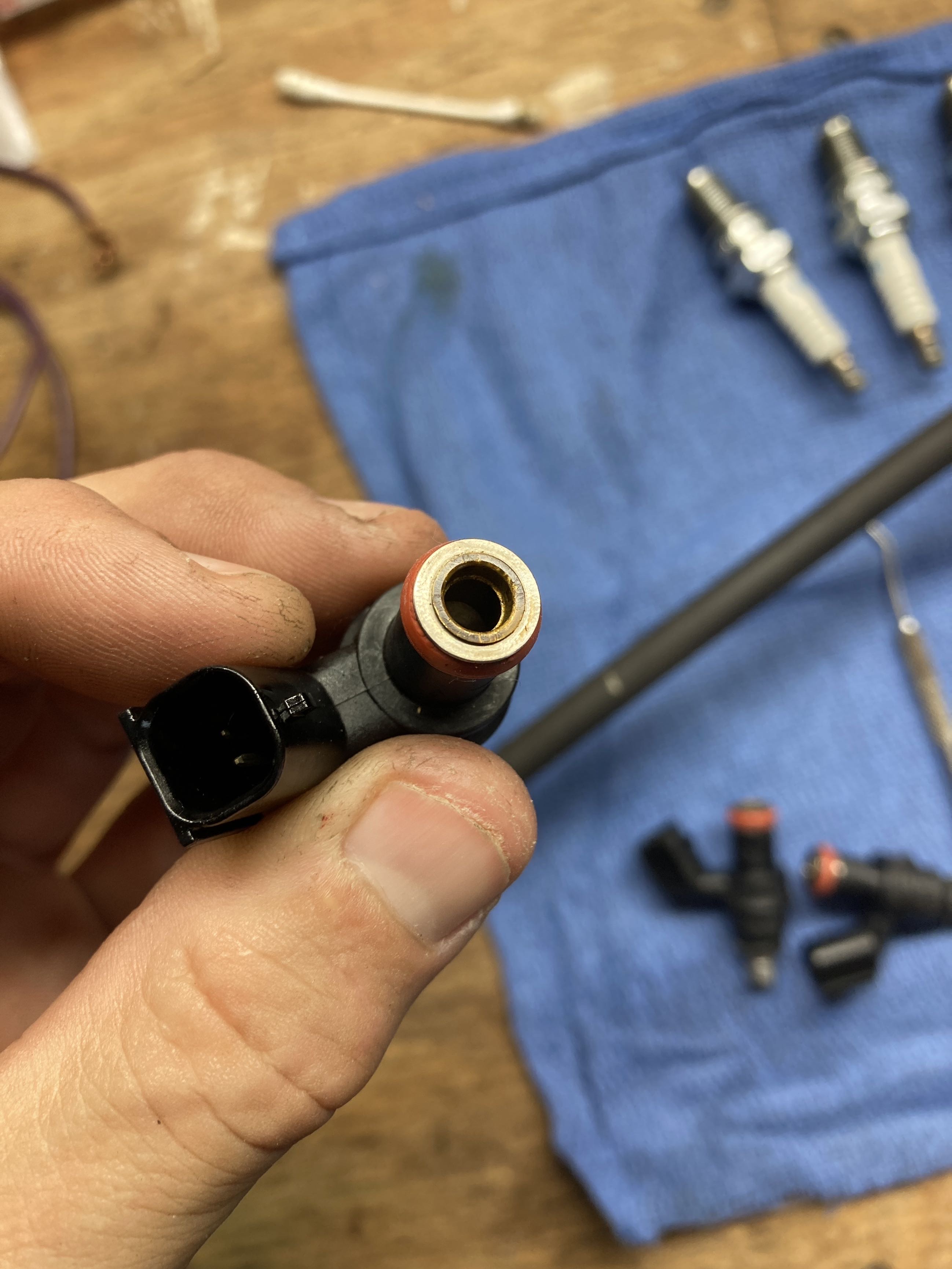

Ok I got the new injectors in and the idle and throttle response has definitely improved. Whoever was in it before me completely took the injector screens out and I didn’t notice until comparing them with the new ones. I brushed the spark plugs off before running it with the new injectors so I could see what they looked like after. And they don’t look great. Could this be all the extra gunk that was in the valves? Or do you think it’s just still running rich.
I did the code checking procedure and I just get a continuous steady pattern of long blinks. No short blinks. Not sure what that means. It still seems to have a tiny stumble while idling but not bad at all and it seems to be way more responsive when given throttle.
My dad will be here later and we are going to check the valves, but not sure they would cause this issue of plugs getting dirty within 10 minutes. Any ideas what to check next? Should I buy a service manual and start checking all the sensors related to fuel management?
Here are some pictures of the old and new injectors, and also the plugs. Those plugs were basically new and fairly clean when I put the new injectors in just for perspective of what it’s doing. Could it be a bad o2 sensor making it throw extra fuel?
Any idea are appreciated, thankfully improvements are being made.
