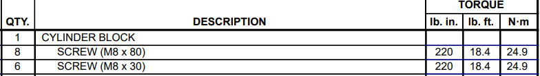

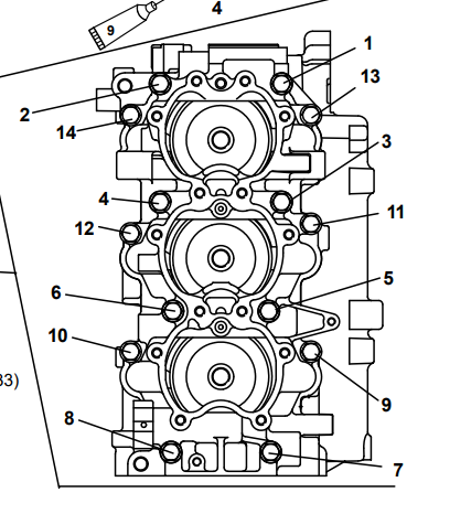

Hi guys, can anyone tell me the torque specs for conrod and crankcase bolts please. It's the late model 3 cyl 60 2str
Here is torque pattern
Here is torque

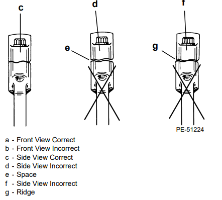

Here is rod bolt and is inch lbs. DO NOT REUSE ROD BOLTS!!! ONLY NEW ONES!!!
