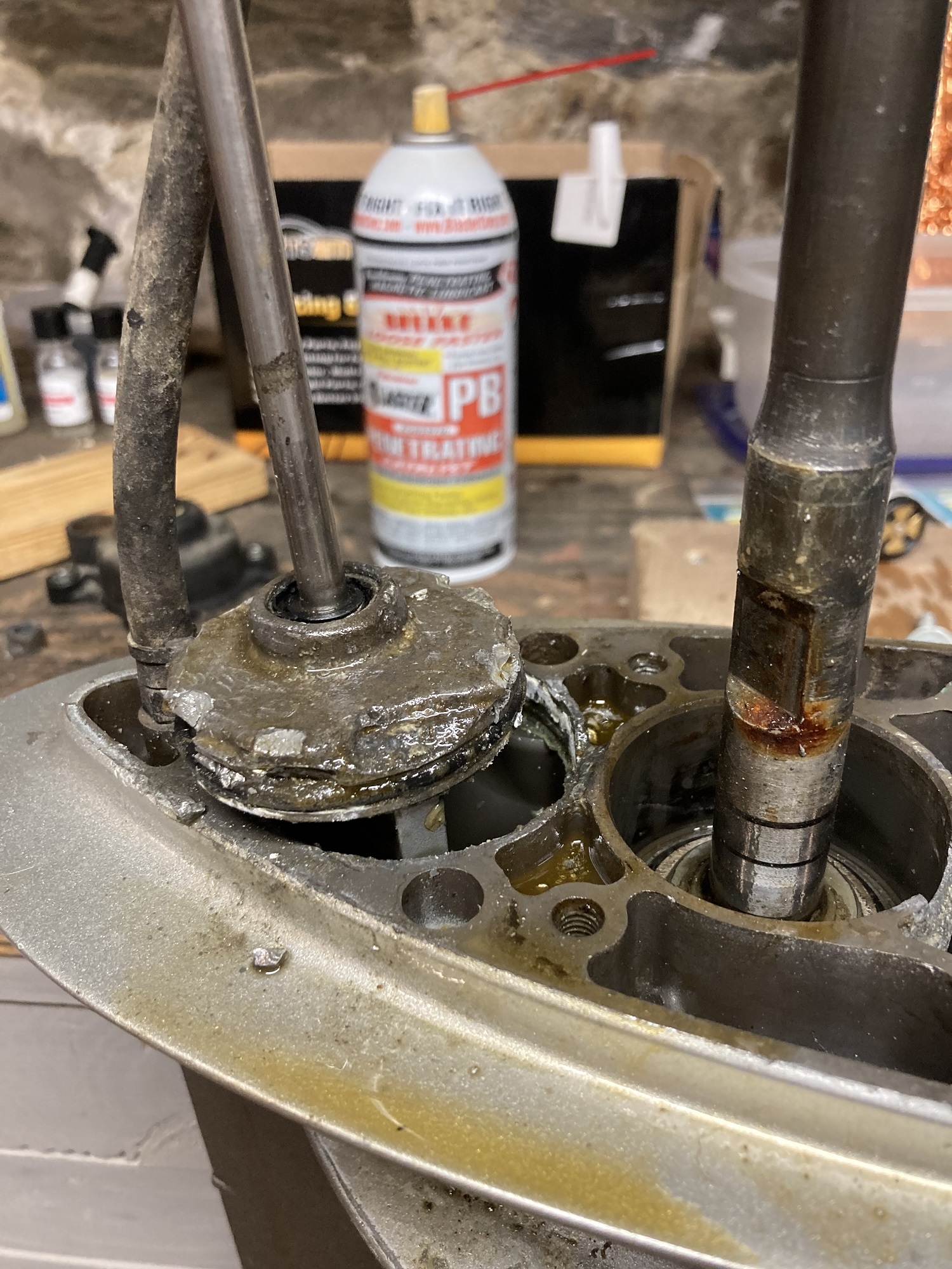

Doing impeller kit and noticed some degradation of this shift shaft seal. Zero water in gearcase oil. Just looks like the really fine edge of this rubber is tearing. From what I can find online of similar models, seems like a pain to replace. Can anyone confirm? And would you guys agree to leave it?

As long as you're in there you should replace it if its bad.It looks like you can remove the 4 bolts on the cover,remove it,pry out the seal and replace it.I'm not a Honda mechanic but it looks like a easy repair.
That seal is a pretty easy project. Getting that cover up and out of the case is the hardest part of the job, and in my experience will demand the most patience. It needs to be pried straight up (carefully, or you'll need one of those too!). I generally use progressively larger screw drivers. There is NO issue sliding the cover (w/installed seal) up over the shift shaft. When ordering the seal, make sure you order the O-ring that goes on the cover to seal it to the lower unit (see #31 in above diagram). You'll want to replace that as part of the seal replacement job.
So that was an absolute bear. Glad I did it- it was really jammed up in there. Cleaned it up and gave a light coating of POR-15 to the weathered areas.
Take a look at the loss of material below the water pump. Luckily this is still covered by the cup underneath the base plate.
So, for anyone with this style lower unit. I'd say to keep up with maintenance on that gear select cover before it welds itself in there like mine did. Lot of torching and banging like a caveman.
Flushed the gearbox from the top-down because there was no way to avoid some particles dropping into the bearing below the water pump.

Wowee! That's a new one on me! If you have that kind of corrosion going on, wait until you try to r&r the prop shaft bearing carrier - to replace the prop shaft seals for instance! These are pretty well known to split the case (yes the MAIN lower unit/case!) on either side due corrosion build up between the bearing carrier and the lower unit/case. Crack will run parallel to the prop shaft. That'll require a skilled welder to repair..... Manual says you're supposed to remove these (the bearing carriers) every couple of years for a thorough cleaning of the affected areas - but I've never spoken with anyone that knows anything about that. ALL seem to learn the hard way - myself included... I can offer one tip. That locking ring that holds the bearing carrier in place? Don't even try to unscrew it. Drill a couple of holes through it about 3/4" apart (I do this down near the bottom), then break the 3/4" section out. THAT will allow the easy removal of the nut. THEN the struggle to get the bearing carrier out begins..... To reassemble, clearly those threads will be in dire need of cleaning. I use a small stiff wire wheel chucked in a drill for that. Have a new ring nut handy, and work on the threads until that new ring will screw in by hand. That's actually not as hard as it sounds.... -Al
