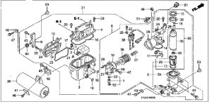

Fuel Screen inside Vapor Separator is clogged
The VST has never been removed and the engine has approsimately 400 hours.
Plan:
1 - Replace RACOR
2 - Replace Low Pressure Fuel Filter
3 - Disassemble and replace Fuel Screen in VST along with all O-Rings.
Anything else you guys can think of to start with?
