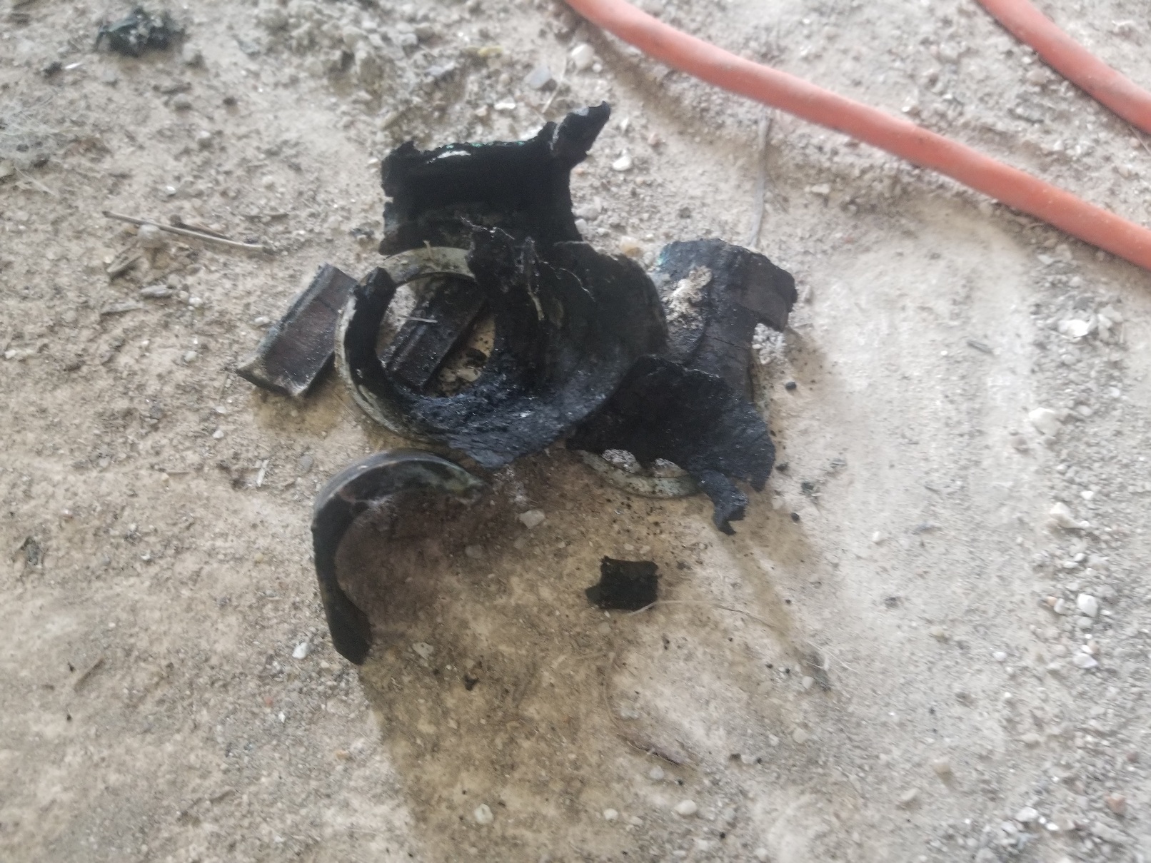

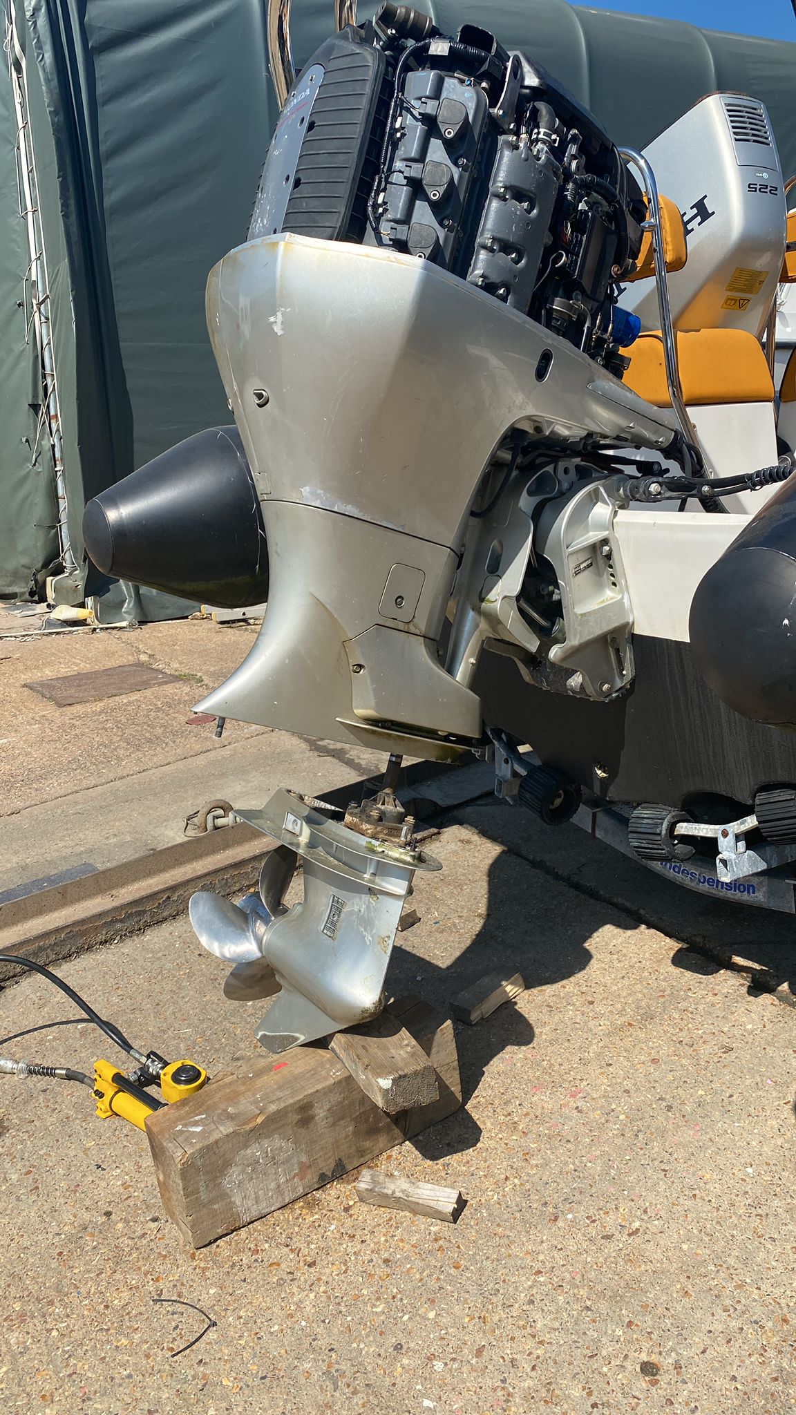

Hi,
wondered if anyone can give some advice. dropped the lower unit of and cannot get driveshaft any further of than shown in the picture. the lads in yard have tried everything to get it to move, including a hydraulic press, nothing seems to be able to get the shaft beyond this point? my questions is what could be causing shaft to be stuck where it is, if it was an issue in the block surely it wouldn't have gotten down that far. I'm thinking it could be a bearing but I'm not sure. anyone have any ideas of the problem and potential fix?
thanks in advance
