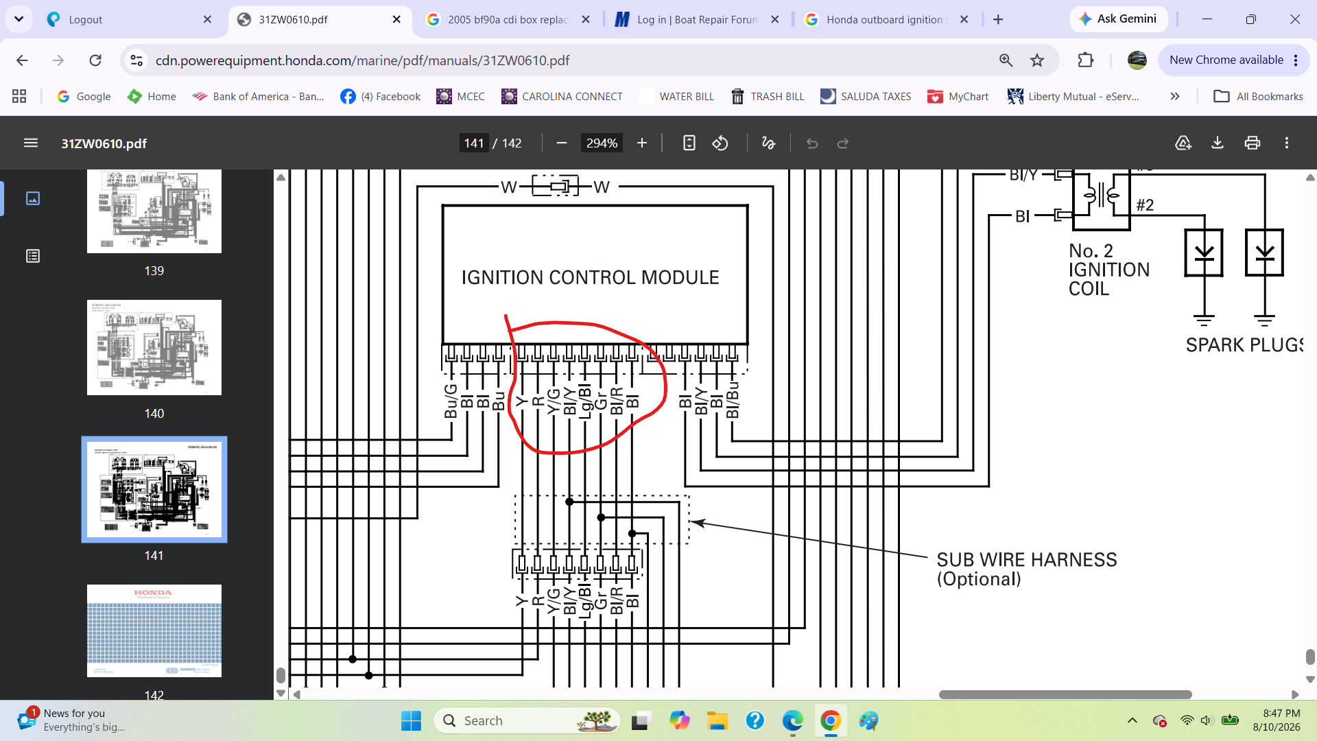

Can any experts tell me what these wire do. Input values/output values? I have weak spark across all cylinders and no spark on cyl 4. All that I can come up with is that I have an issue with the boat side harness. I have disconnected the harness and want to start the engine eliminating the boat harness before spending money on a CDI box. I have swapped coils,wires,plugs everything that I can think of to pinpoint this problem. I have a weak spark on all cylinders (don't know the source). 1,2 and 3 will light up but #4 will not. #4 will light up a timing light but not the plug. I have been troubleshooting for several weeks now (bout to lose my mind). All comments welcome... Need to know what wires are needed to run the engine independant of the boat side harness. 2005 BF90A. 12 volts to bl/y to power the CDI and ground to bl/r to stop? Bl to ground? Is anything else needed?
