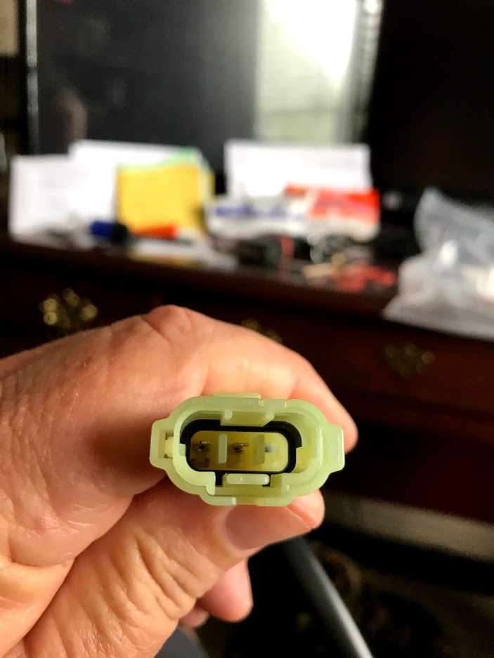

OK, received the new switch control panel. I compared with the old switch panel and noticed the long pig tail connector only has two wires (red/blue stripe, white/blue stripe). The old switch panel long pig tail has three wires (red/blue stripe, white/blue stripe, yellow/black stripe). The new switch panel does not have a yellow/black stripe wire that I can tell. I know the old switch (Part no. 36452-ZW7-210AH) was superseded by the new part no. 36452-ZW7-410AH. Can anyone give me any insight to the difference and will this new switch work? Pictures attached of the new and old.

Yes it will work, the only thing is the check eng light will glow dimly all the time buy go bright when activated. I have the same issue and don't worry about it. The alternative is to mount a separate old style light panel which I couldn't be bothered with.
