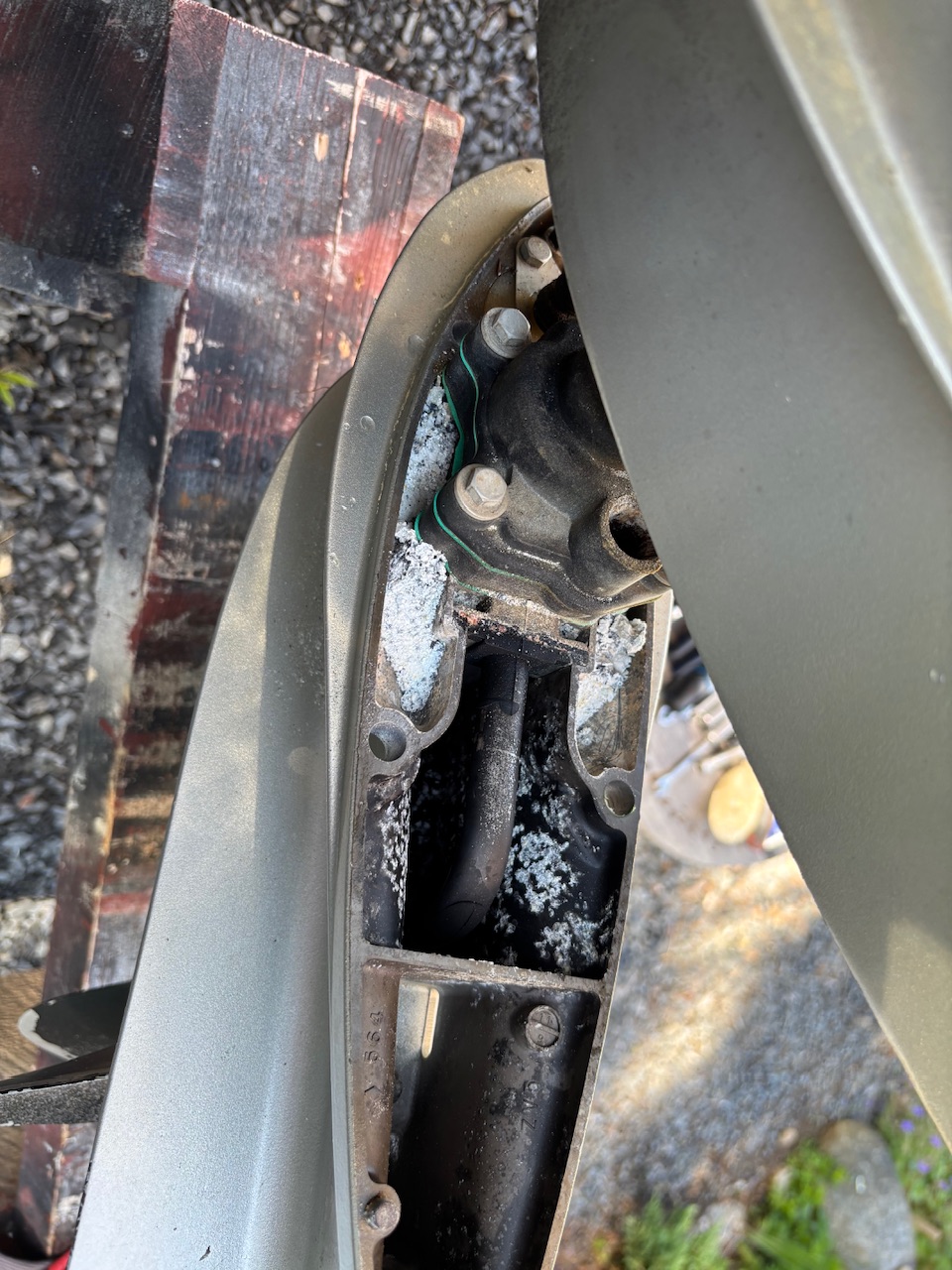

All the valves were tight. Put the complete new impeller kit in it, found some salt, looked like sea salt with some spice added.
Looks like that could go right on your salad!
Doesn't seem to be any signs of corrosion though.

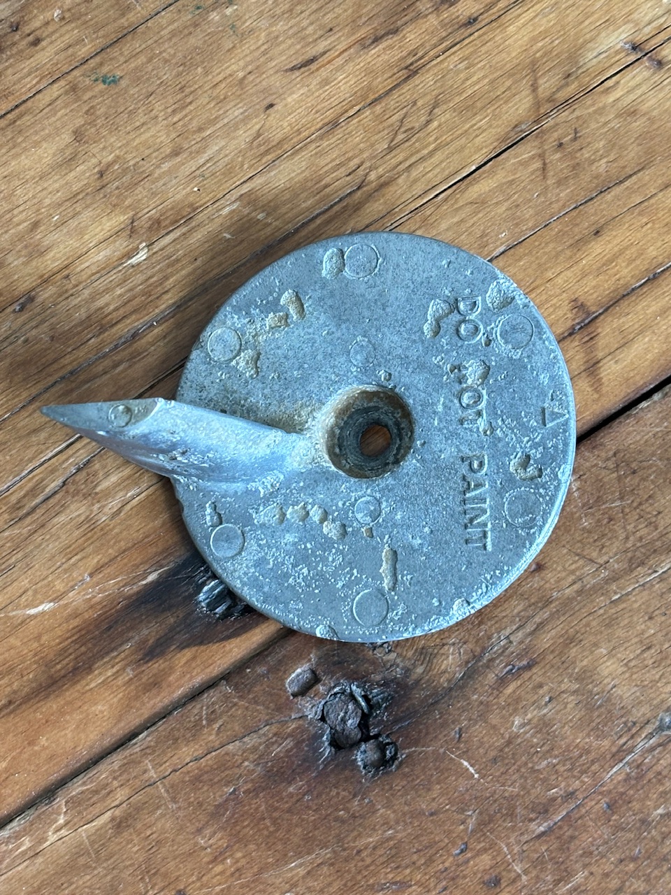

He must keep up with his zincs.
That just means that they've been doing their job. "Sacraficial anode" says it all.
As an aside, it always kills me when I see the little ground bonding strap used for the power trim units rotted in half or, worse yet, completely removed because people don't know what they do and, thus, don't think they have any importance.
I don't think enough emphasis is put on those or maintenance of the zincs in the OEM literature.
