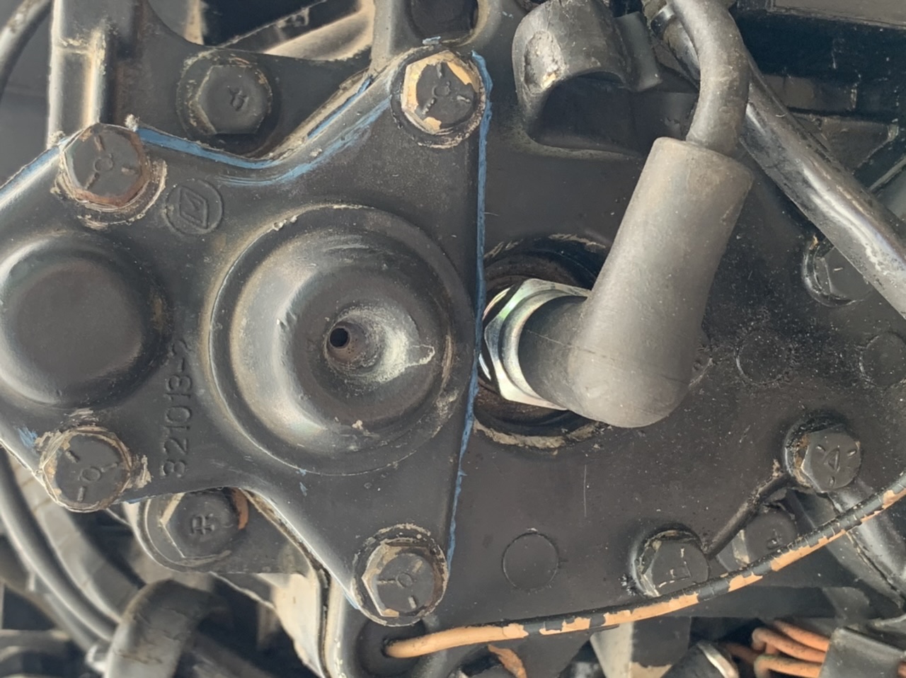

Here are a few pics to help. Also, I took a picture of the port side head where it’s white. I think that’s the poppet. Does it look burned?

That hole is a vent.----It allows the poppit valve diaphragm to move.------The white stuff may indicate that it is leaking.------And no do not plug that hole.----Have seen some folks plug that hole.
