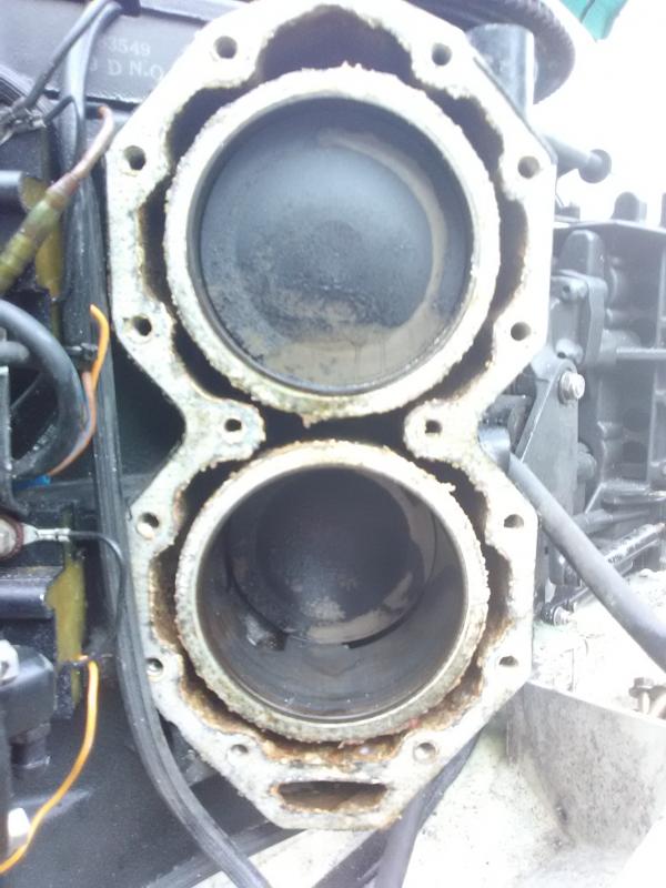

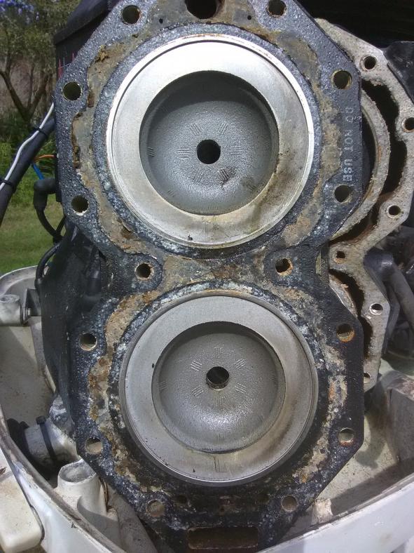

This morning I got into the starboard head (and the one with the temperature sender in it.) Here's what I found:
OK, I could only do the single picture, so...
OK, it must have been the picture size. Shrunk by 50% and they worked.
Anyhow, it appears the diverters are missing. Possible cause? Also, is there a reason (besides the obvious) that the head is marked with the text depicted???
Throw away the head gasket and scrape clean all the water passages with whatever fits in there (screw drivers, wires, bottle brush, broken glass....) When you are satisfied with the cleaning, put on the head gasket, torque on the head and you are ready to go test it. That should do it.
It says "sealer" under the do not use. Just cant read it well with the crud that's built up.
Thanks for that. After reading your comment, I looked closer & saw the rest of it. Whew - I was worried some idiot had installed factory rejected heads! LOL
I'm going to give that a try, but I think I'm also going to put in some diverters. I'm thinking the missing diverters was my primary problem. I believe missing diverters allow the water to come in & go right back out, without having to complete a circuit, past the upper part of the water jacket. If I'm wrong, I hope someone will correct me.

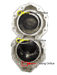

Here's what I have from the service manual:
The head gaskets pictured in post #25 do not look like V-4 looper head gaskets.-----If you are working from the wrong manual then what can I say ?
Well, SOB, someone get me strait. Are there separate diverters for the head and for the block? I'm no pro (probably very obvious, at this point) & am just trying to figure out this overheating issue. I thought I had found the issue with the "missing" diverters, but maybe not. Here are some images of my block, head and head with the gasket on. Can anyone help me figure out what engine I have (if it's not a looper) & where (or if) the diverters should be installed?
I don't mind cutting and installing diverters for both the heads and the block independently, I just want to make sure I do it right.
Well,-----What does your factory manual say ?-------And does a parts breakdown of your motor show any diverters ??????------Note---- those head gaskets in post #25 are for a " crossflow " engine and you are working on a looper style engine.----Totally different machine.
