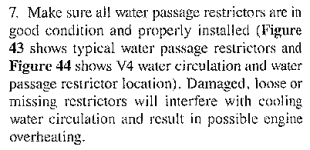

Well,-----What does your factory manual say ?-------And does a parts breakdown of your motor show any diverters ??????------Note---- those head gaskets in post #25 are for a " crossflow " engine and you are working on a looper style engine.----Totally different machine.
Good question. The shop manual doesn't distinguish between Loop-charged and cross-flow blocks, with regard to diverter/restrictor installation. It only distinguishes between "typical water passage restrictor" and "V4 water circulation and waterpassage restrictor" locations.
Also, I don't see diverters listed here at marineengine.com for this motor, but I also don't consistently find it shown for some known crossflow engines, either. Some yes, some no, so it has helped me remain confused. :-D
You have a looper 100%....no diverters in block
Thanks for helping me nail that one down.
