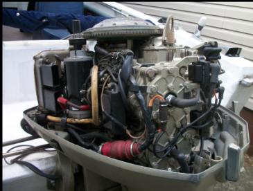

Post a picture of the motor with cowling off.----------No distributor cap on a 78 model.-----------Sounds like it is running on 2 cylinders.------Check compression.----------Check for spark on all leads.-----------Do not run it again untill you confirm carburetors are clean.--------If the seller ran it without water for every demo you need a new impeller !!

I have 4pics don't know if I was successful.

It is a 78 model verified by your pictures.-----Now outboards are a different animal and your automotive wisdom does not always apply.-----Heed " top notch " advice given here, from folks who started repairing these machines say 50 years ago.

Please HOW can I test the engine coil pack to determine (if bad and) which side it needs to go to??? (port or starboard).
Could it be as simple as testing it by holding spark plugs to the block to see if there's an arc? (like on a car motor)...
Put the " car thinking " away.------That unit is the CD module.-------It can go on either side of your motor.----This item takes signals from stator and sensor coils to send signals to the ignition coils.----Your manual will explain it all.---Guessing will get expensive for you.
