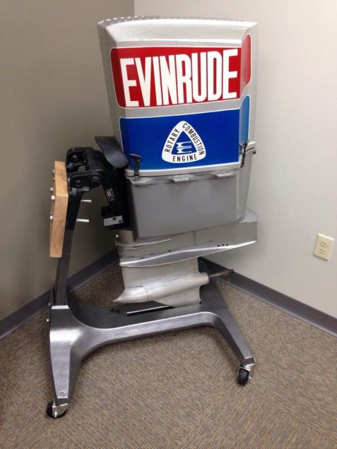

Nothing wrong with the old Cats....I even had the Panther with the Wankel motor. Here is a Johnson Wankel....remember?

Did they ever try a Wankel on an outboard? Really unique/cool exhaust note.....how about a motorcycle. Noisy Harley's are getting obnoxious now....the novelty is wearing off for me.
Sure I have a ---Mac 10----An Italian made ( 1972 ) outboard motor with a SACHS Wankel powerhead.-----Picked it up ( $50 ) years ago just to see how it was put together.----Just a parts motor.----Find examples running on Youtube off course.----Interesting item.----Not a really well built item in my opinion.
Holy balls, 7000 rpm? Wonder what it sounds like? I always thought we could go places with the Wankel. Sister in law had one in a car. Tuned it up for her. Not much torque, but could it wind up? Now with CVT's.....constant velocity tranys.....able to keep these motors in their narrower powerbands, maybe the Wankel will see some hope. So simple, add fuel injection....ceramic or carbon fiber composites.
