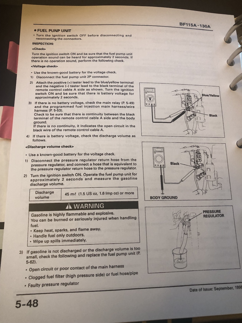

Wasn’t sure it was the correct one from your earlier comment.
Is your problem with testing the relay- got any butt connectors to use on the posts to do the test?
I read the test procedure and I don't think you need to go through all that.
If you can access the power plug to the hp pump right at the VST, you can simply unplug it there and test for power from the main relay (2 seconds) when the key is cycled to on.
Then, you can apply battery voltage and ground via jumper wires to the pump at the other side of the connector to see if it will run. Don't leave it connected for more than a few seconds. It would be wise to put an in-line fuse in the positive jumper wire when testing this way.
You said before that the pump clicks inside the VST so I predict it likely that the pump is locked up.
Just my opinion.
Good luck.
