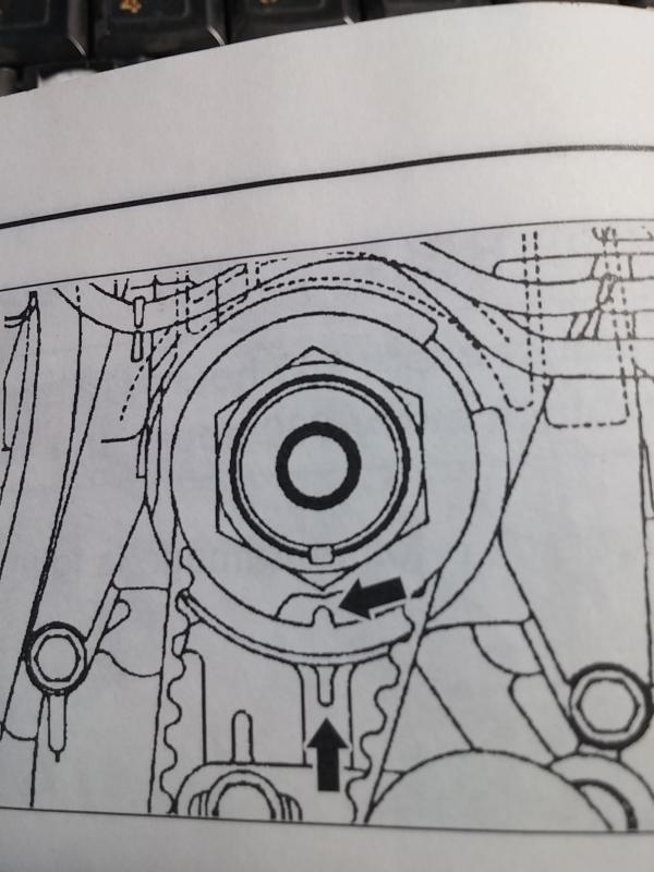

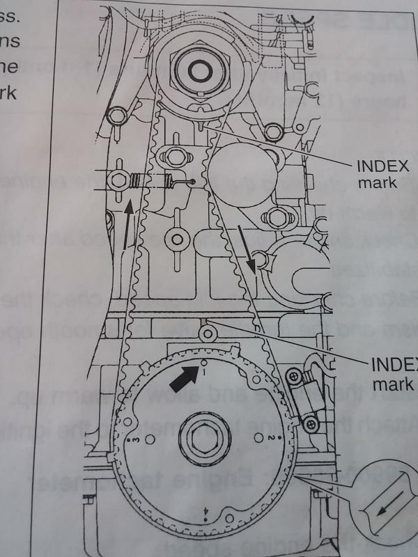

Here are two pics from the manual regarding timing belt / valve timing.
Study these and find the correlating marks on your engine. The index marks, and the crankshaft pully half-moon cutout are key.

Why haven't you compared the pics I posted with your engine's timing?
Take the plastic flywheel shroud off, examine the camshaft pulley area, and compare to pics.
That is easy to do.
Then look under aft rim of flywheel with a flashlight and examine the timing belt pulley on the crank.
Once you see what and how and why (figure it out) then turn the engine clockwise until the crank index mark is
as shown in the pic. Then look at the cam index mark; it should be right there as shown in the pics, if it is still in time.
