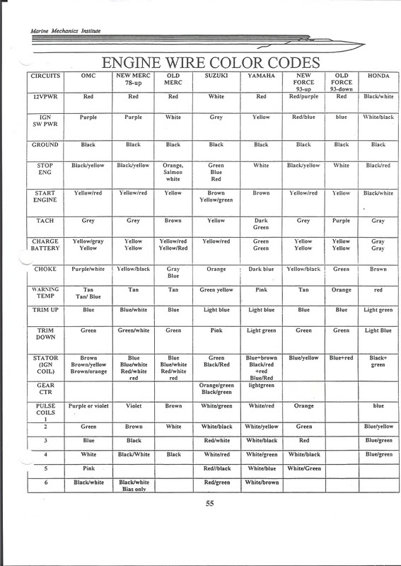

Installing the Sierra 6-wire switch to my Yammy harness. I've got the red, black, purple, and yellow w/black stripe connected. Can't figure out where the yellow w/red stripe or blackw/green stripe connects to my Yamaha harness. HELP!!!
You need to look up yamaha outboard color chart, Mastertech Marine have one on their site, cross reference with your sierra color chart and go from there
