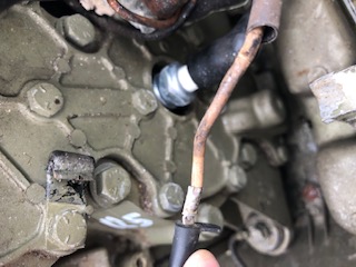

So i read another thread that gave some brief instructions on testing the horn, if i understood correctly, on this wire i have an image of i pulled the rubber back, and rubbed the silver connector against a couple of the bolts in the background while the key was in the run position? anyway i did that and nothing happened.

If horn failed to sound it likely bad....that model 50 has domed pistons and compression runs high. Compression test means cylinder will support combustion but does not mean there is no damage. I see this problem with these models all the time as crankcase halves leakage and worn/scuffed skirts on piston. Reason it wont start in water is backpressure is higher than crankcase pressure and cannot force the fuel/air mix into cylinders. It will start and run on muffs with no problems
