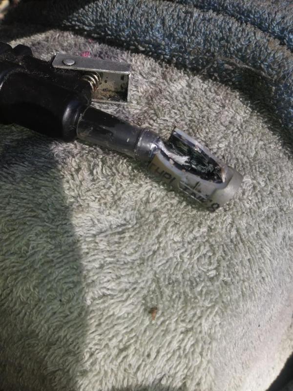

Under load, you will require much less fuel, that is what I would focus on. I would look at your tank and supply line up to the fuel pump, or try a remote tank (6 gallon). Could be something as simple as a defective vent, or primer bulb, collapsed hose. Check out this picture, just last year, ethanol? Happened up in the middle of nowhere Ontario. October, nobody for 30 miles. Lucky I caught it right away.
